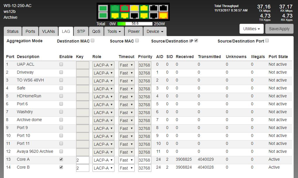

Re: LAG

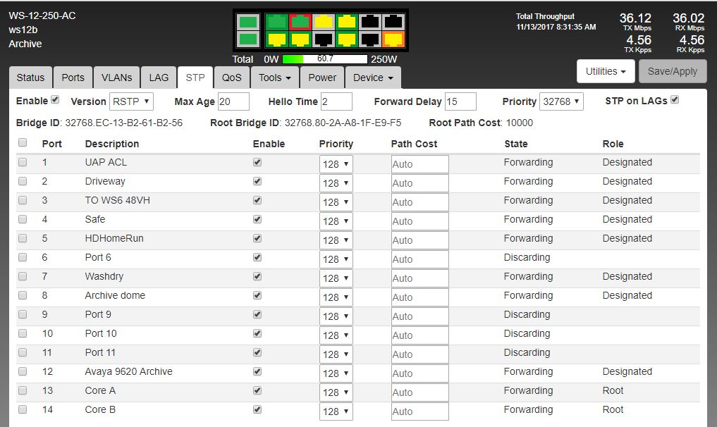

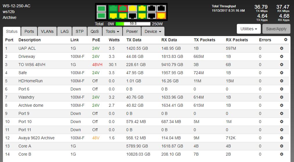

Everything Chris said is spot on, and I'm a visual kinda guy who likes to see examples so maybe this will help.
This switch is using SFP but it is the same with copper, just make the settings the same on both sides.
You'll never fully balance the links.
Depending on the type of traffic (e.g. many clients to many destinations) you can experiment with the aggregation mode to see what works best for you.

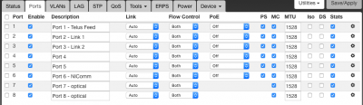

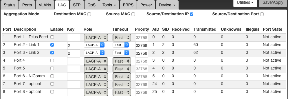

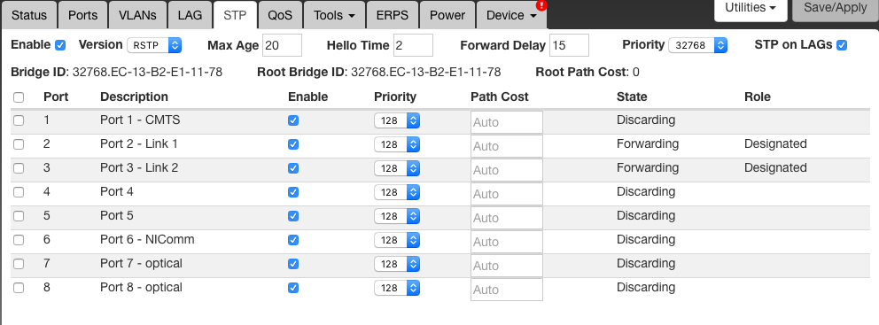

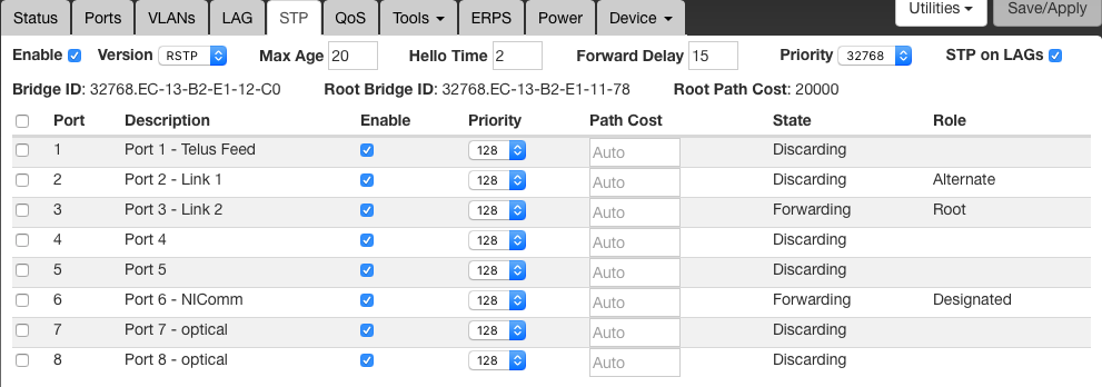

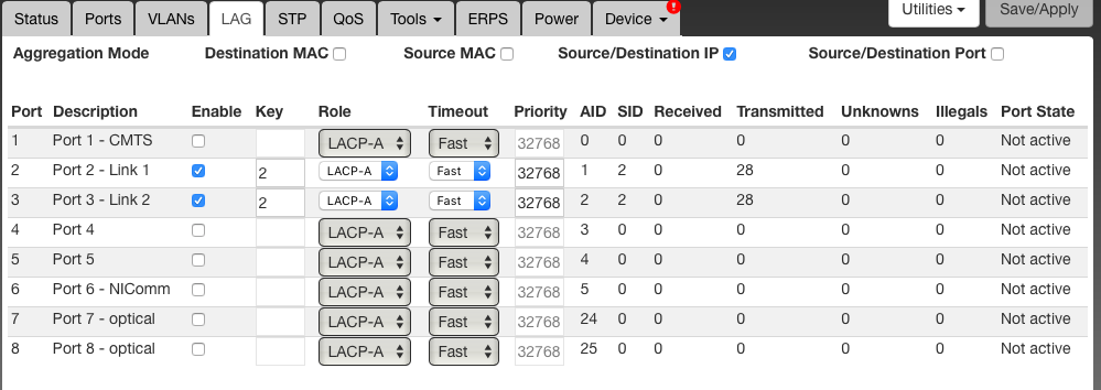

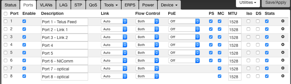

Re: LAG
Thank you for the screen shots, the are always preferred and appreciated
if I have an example of a working copy then I can quickly copy and use it
Have a look at my screen shots, there is something wrong
I'm seeing not active on both links
and root on one and alternate on the other
does not match what I see on yours and traffic will only flow on one link or the other
if I fail the root link then the other link becomes root and traffic will flow on it
traffic does not flow across both
i ran iperf with a far higher throughput than the radio links can pass and traffic only flows down one link
until I fail that link and then traffic will flow the other
but not over both as all of the documentation I have read says it's supposed to
here are the screen shots

Re: LAG
cable guy wrote:I am still mystified why I'm seeing not active on both paths on one side and root and alternate on the other side
Compare that the TX/RX columns to my screenshot - you aren't getting LACP to negotiate for some reason.
What I would do:
- make sure that exclamation on the device tab is cleared on that one switch
- break down the LAG on both sides
- let the links stabilise
- create the LAG with 2 ports on side B
- create the LAG with 1 port on side A let it stabilise
- add the second port to the LAG
Be sure to click save/apply after each change
