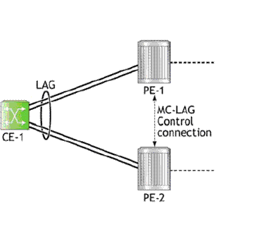

Re: MLAG / MC-LAG Functionality?
He want the 2 ports of the lag to be on different switchs. The LAG device would be still reachable in case of switch failure or maintenance.
Here a picture that explain LAG (between the device and switch) with MC-LAG (between switch):
http://1.bp.blogspot.com/-UrWYIoecIkM/T ... titled.GIF
The device redundancy could also be done via RSTP (if device also support it) but LAG is active/active while RSTP is active/passive. The downside is that RSTP couldn't pass over an ERPS ring unless using an L2 encapsulation like EPL or L2PT.
P.S. (off topic): L2PT is probably support by the vitesse chip and could lead L2 VPN service to a next level since QinQ can't forward STP and discovery protocols.
