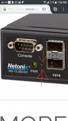

I just had this same thing happen on a WS-12-250-AC. Made a VLAN number change and the unit locked up -- stopped passing traffic. POE stayed up. Power cycled and just the green light comes on, fan runs but the unit won't boot and at no time do the port lights illuminate.
Problem now is without opening the case I can't find the reset button to try getting it back to factory defaults to see if it will at least boot up. Where is it?

hello next to the green led there is a hole there is the reset button

correct

Thanks! Would help my old eyes if there was a white circle around it at least, short of "reset". Anyway, that restored operation so the switch will now boot up. Question is, why did this happen, and more importantly, how to prevent it from happening again? This was in production when it occurred. If bad memory is suspected, is there a way to test it? This is a rev. F unit -- not very old.
