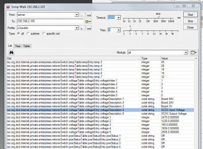

I cant seem to find the OID for the Input Voltage
v 1.4.7
Dude 4.0beta3
MIB file loaded
Input Voltage Oid

Re: Input Voltage Oid
Hi sirhc
I have updated the WS-12-250-DC but still cant seem to find the correct OID for input voltage, any idea why ?
Its 1.3.6.1.4.1.46242.4.1.3.4. Entry 4 in voltageTable
Do you have the latest MIB? viewtopic.php?f=17&t=251
I have the latest MIB file
I would like to see the input Voltage
I don't understand what you are asking. I gave you the OID for the input voltage.
I dont understand why the voltage is being expresses in ms rather than V, can someone help with that?
