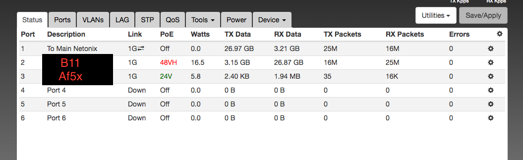

There is a Mimosa B11 plugged into to ether2 (48VH) and an AF5x(24V) plugged into ether3 of the mini. The radios are assigned to different vlans. Ether 6 of the mini is on the management vlan. When I power on the AF5x interface, traffic passes through the AF5x radio link. When I power on the B11, traffic stops flowing through the AF5x link. The AF5x does not power off (I can log in from the remote side of the link). When I power the B11 off, the AF5x link starts passing traffic again.

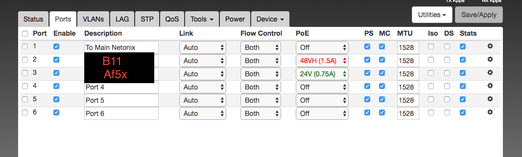

You do realize you should power AFX radios with 24VH, 48VH, or 48V over 24V

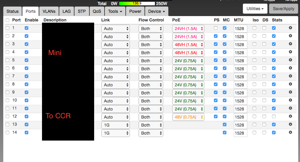

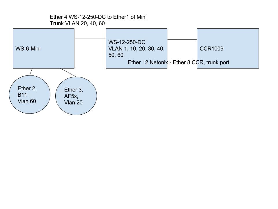

Please Post up screen grabs of the config Tabs of both switches and a diagram
viewtopic.php?f=6&t=1215#p9040

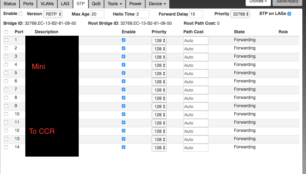

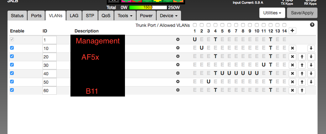

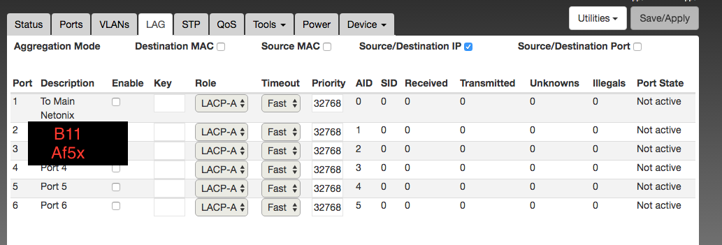

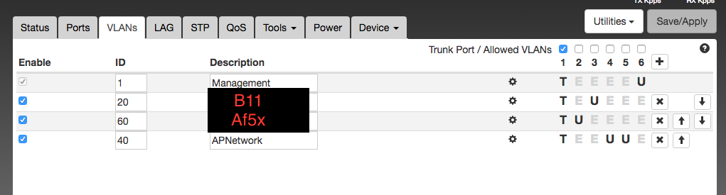

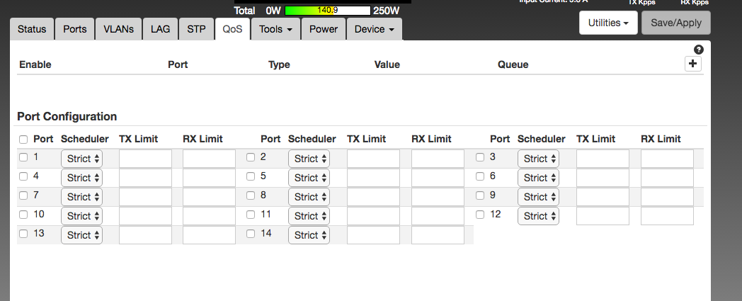

Here you go! Thanks

But I would power the AFX with 48V instead of 24V

No this is not your cause, it is simply a suggested better method to power the AFX radio (more efficient)

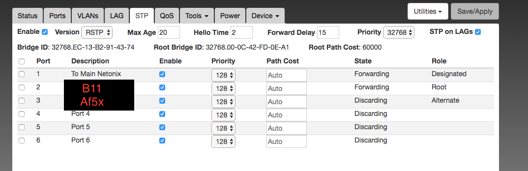

Your issue is with RSTP and VLANs, RSTP is clearly seeing a loop and setting the port to Discarding.
Watch the WS-6 MINI STP TAB as
