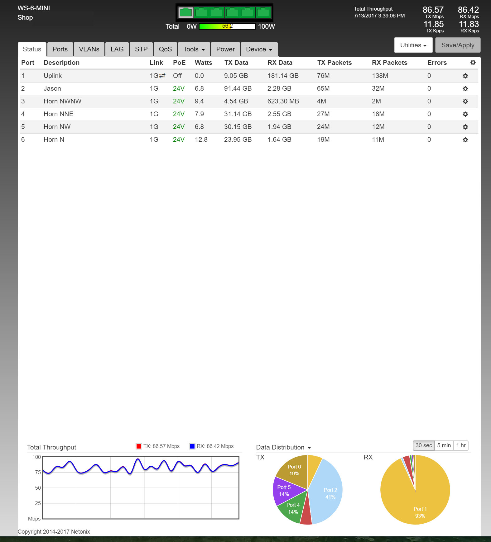

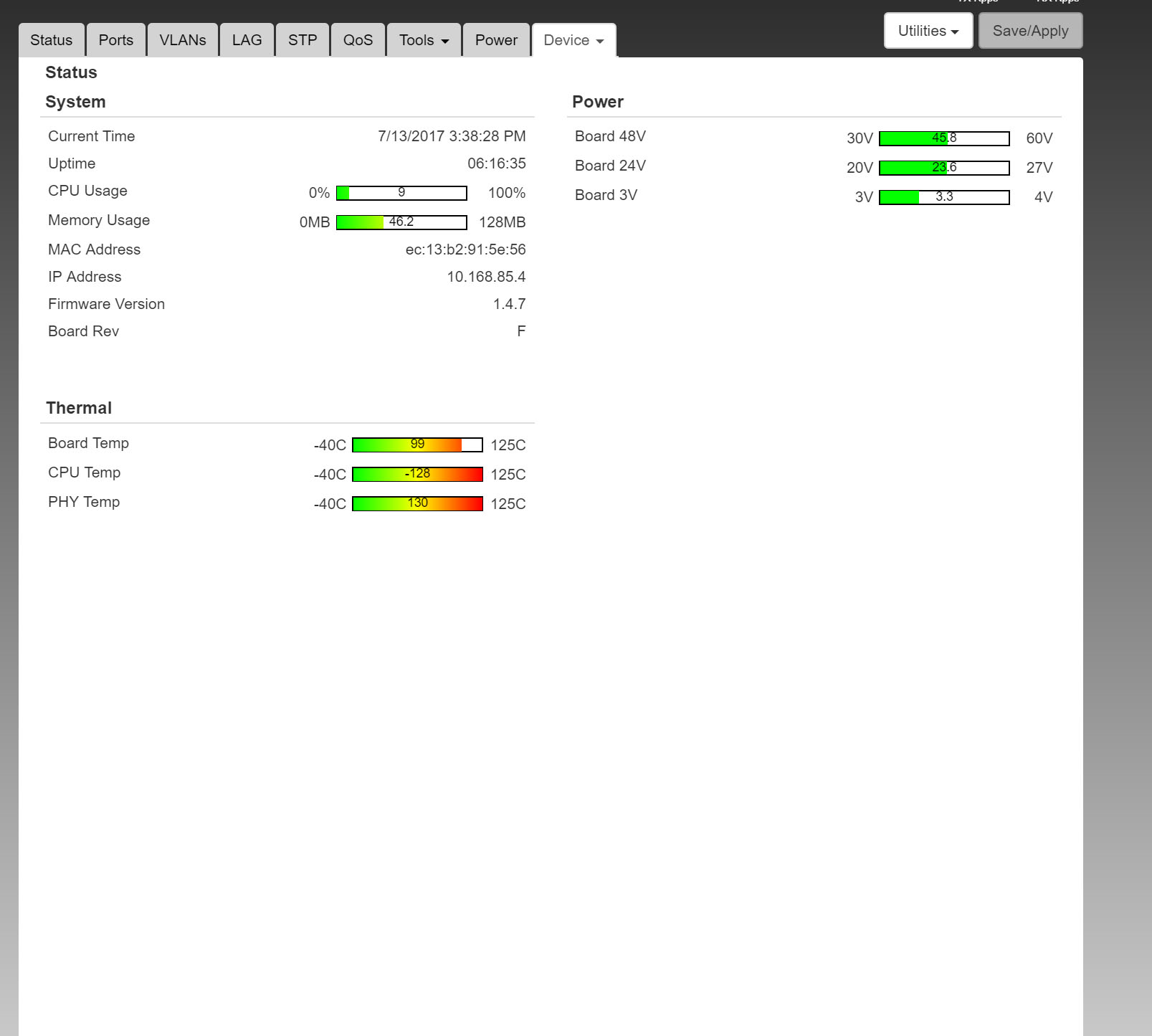

Installed a new WS-6 Mini this morning. It's 106 Degrees outside but we routinely get temps up to 122f (Like last week). Should I be worried? Bad unit? I read somewhere that the cpu temps sensors have a pretty wide range so it could be off?
I have about a dozen of these outside in the same boxes pulling around the same wattage and they don't get nearly as hot. Hottest one on the network besides this one is at 107C right now.
Not sure why the CPU says - (minus). It was around 126 a few min ago before I did the screenshot.

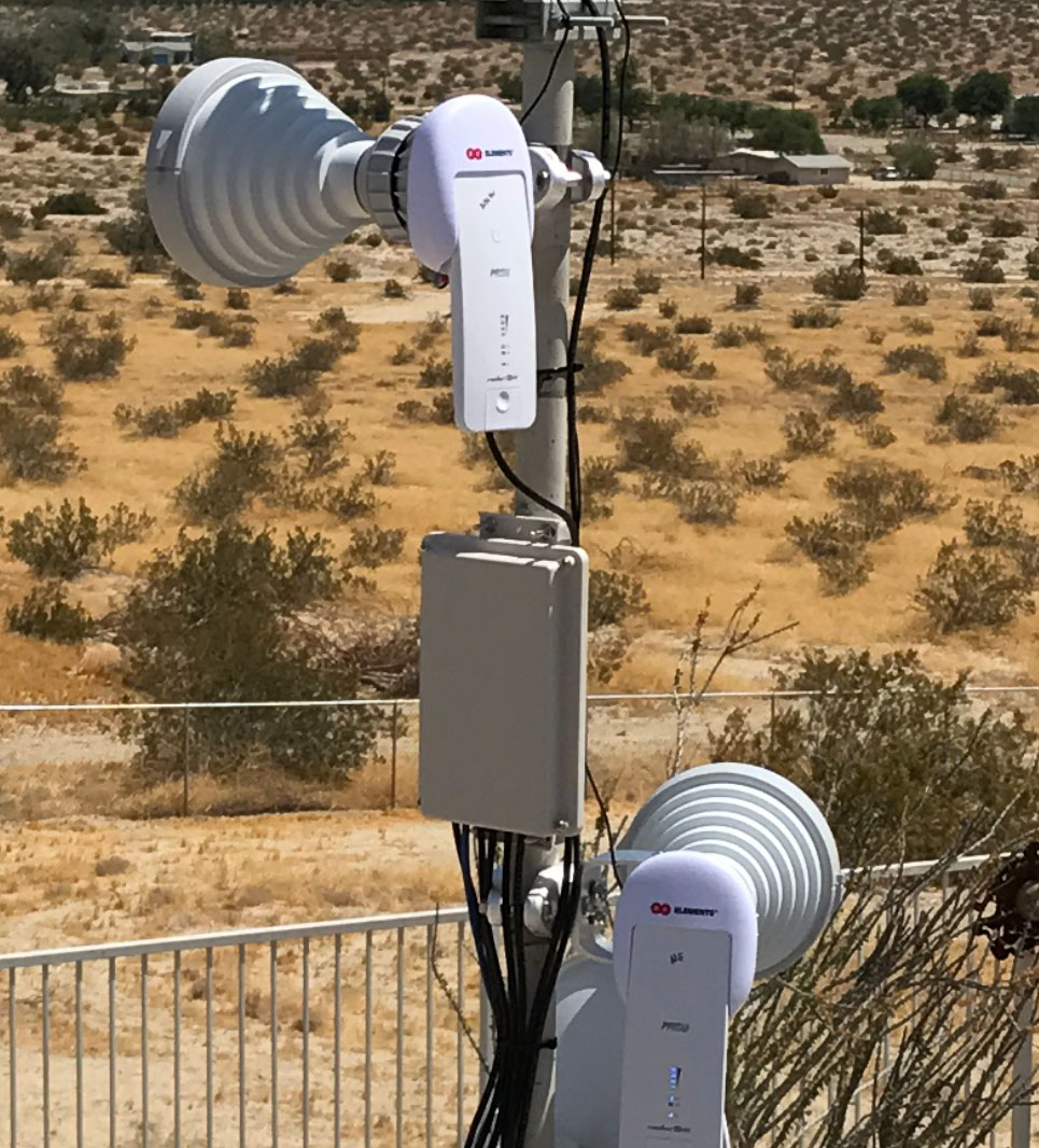

I would install vents in the box
One high and one low to allow air flow
