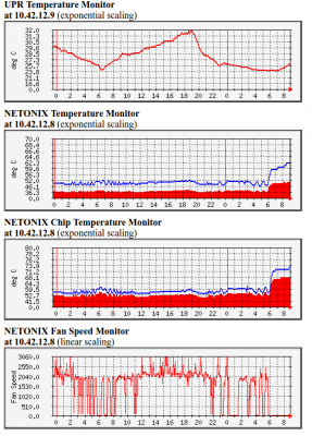

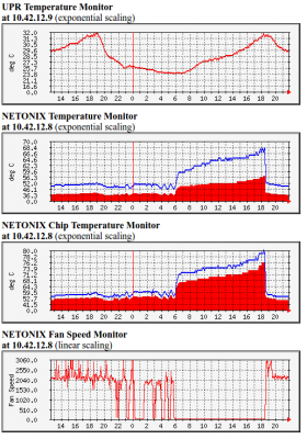

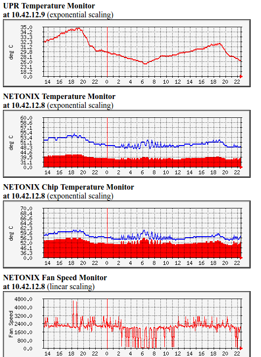

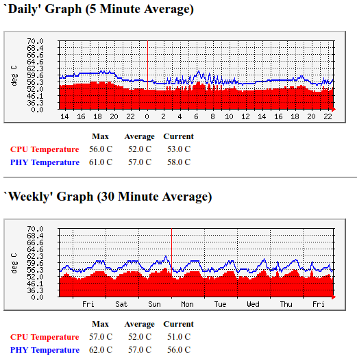

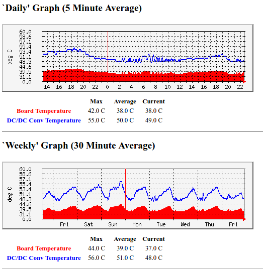

Here are mrtg graphs of packetfulx temp, netonix temperatures and fan speed for the last 30 hours. We had high heat on the previous weekend, so I'm including separate 30hr and 1 week mrtg graphs for the netonix temperatures and fan speed (only stared fan speed previous weekend).
Sooo.... are we likely to see fan failure and subsequent switch failure when deploying?

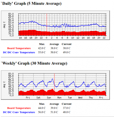

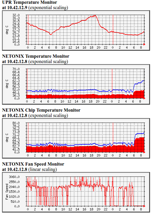

Below is a screenshot of temperatures and fan speed.
top is packetflux temp
next is board temp (red), DC/DC converter (blue)
then cpu temp (red), PHY (blue)
then fan speed

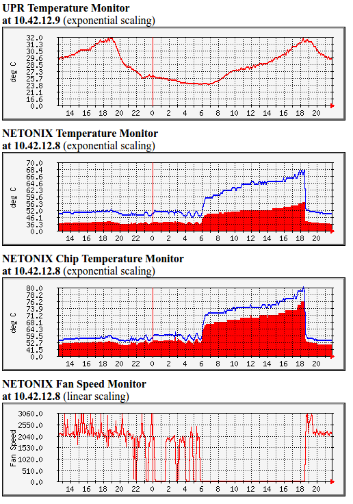

Well, interesting. As I was preparing a RMA request the fan started up spontaneously (after 12hr).
The temps dropped rapidly after fan startup (within the 5 min snmp sampling for mrtg graphs).
From the log: Jun 24 18:30:09 switch[1345]: Fan 1 is now working
I went ahead and sent the RMA request.
Here's the mrtg graphs showing temp drops and fan start-up

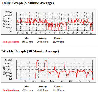

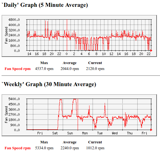

Fan just failed again this morning.
From the log: Jul 2 04:03:06 switch[1345]: Fan 1 is failing (0 RPM, cooling level 255, board temp 44 C)
