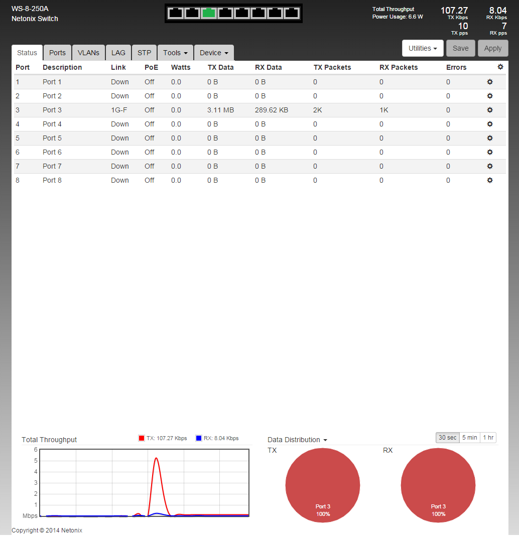

The 8 port version will be released sometime soon.
Here is a screencap of the UI.
Pretty much the same switch software as the 12 and 24 port.
Size is 9" L x 7.25" D x 1 3/4" H

rockhead wrote:Any forecast on price and power consumption ?
Well... the 250 in the model name suggests 250W and the 6.6W on the screenshot suggests around that much with one non-PoE device connected.
Price I cannot deduce from the above. Pirate4
Onscreen power does not equal power consumed.

sirhc wrote:We are trying to get the MSRP in at $249.95 but we are not sure yet.
That's $31.25 per port. With talk of a 12 port in the same small form factor (SFF), I wonder how many would go the extra $100(?) for the 4 extra ports. Assuming the 12 port SFF to be priced at $349.95 ($29.16 per port) like the rack version. Now if the 12 port SFF is without SFP maybe it will come in at a lower MSRP and so it may make it more attractive.
It is hard to predict buyer decisions. I read where someone bought 12 port over 24, presumably to save $200 but then want to buy copper SFPs to get 2 more ports. Add the cost of 2 copper SFPs and the 24 starts to look like the better deal.
