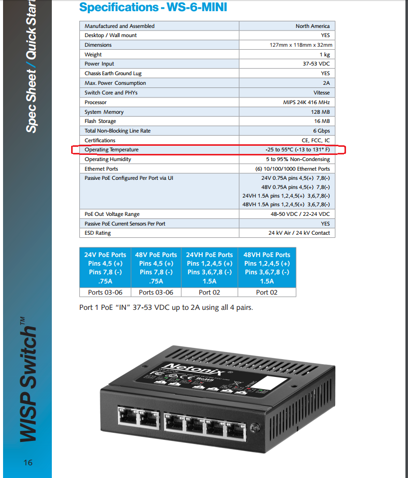

Operating temperature of 55 C (131 F). Not sure what the temp is inside the weather tight box but it easily 100 F on the black roof just a foot away.

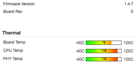

I am having what might be a similar issue. Running a WS-6-MINI on firmware 1.4.7 Twice now when the ambient outdoor temp is above 95 degrees F, one of our WS-6-Mini's stops responding or passing traffic. All of the POE ports are still active and all 3 of the radios attached to the switch are powered but all show a down link on their Ethernet ports going into the WS-6-Mini. If we reboot the switch and everything comes back online. When I look at the logs, I just see a cold boot message. I can't get at the switch before the reboot to look at logs. Unfortunately, this is installed on a roof (outside) and serving a bunch of customers so I can't get at it with console to see what messages are displayed.
It's only happened twice but both times were in the heat of the day on two of the hottest days in town.
To help fix this automatically, since the switch is powered via POE on port 1, can I set up a ping watchdog on port 1 that pings our core router? If it stops seeing the router, will it power cycle port 1 or is that a really bad idea since it will loose power in the middle of the bounce command?
Here is the temp once it came back up:

As I sit here and watch the switch status, the PHY temp is climbing. It's up to 117 now. Outside temp at the switch is 95 F but the switch is in the Netonix plastic enclosure on a flat roof about 6" off the roof deck. I think too much radiated heat.

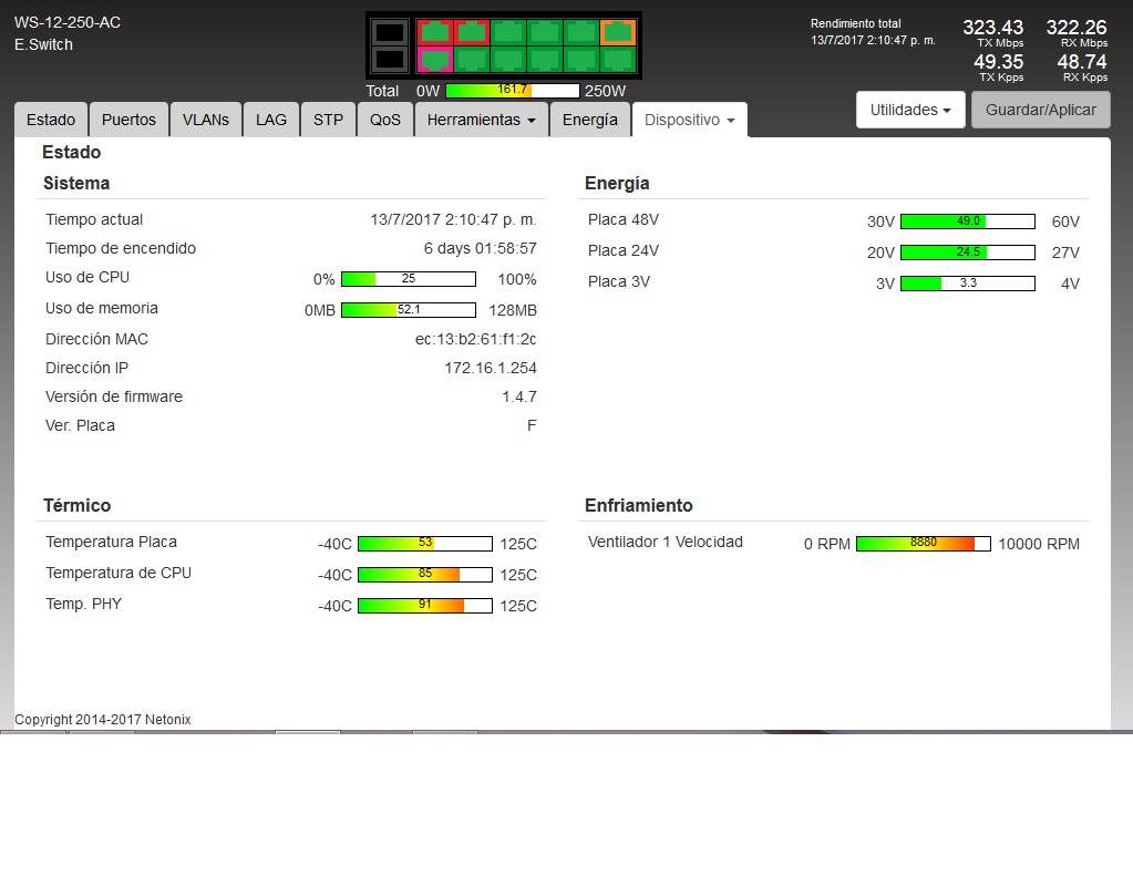

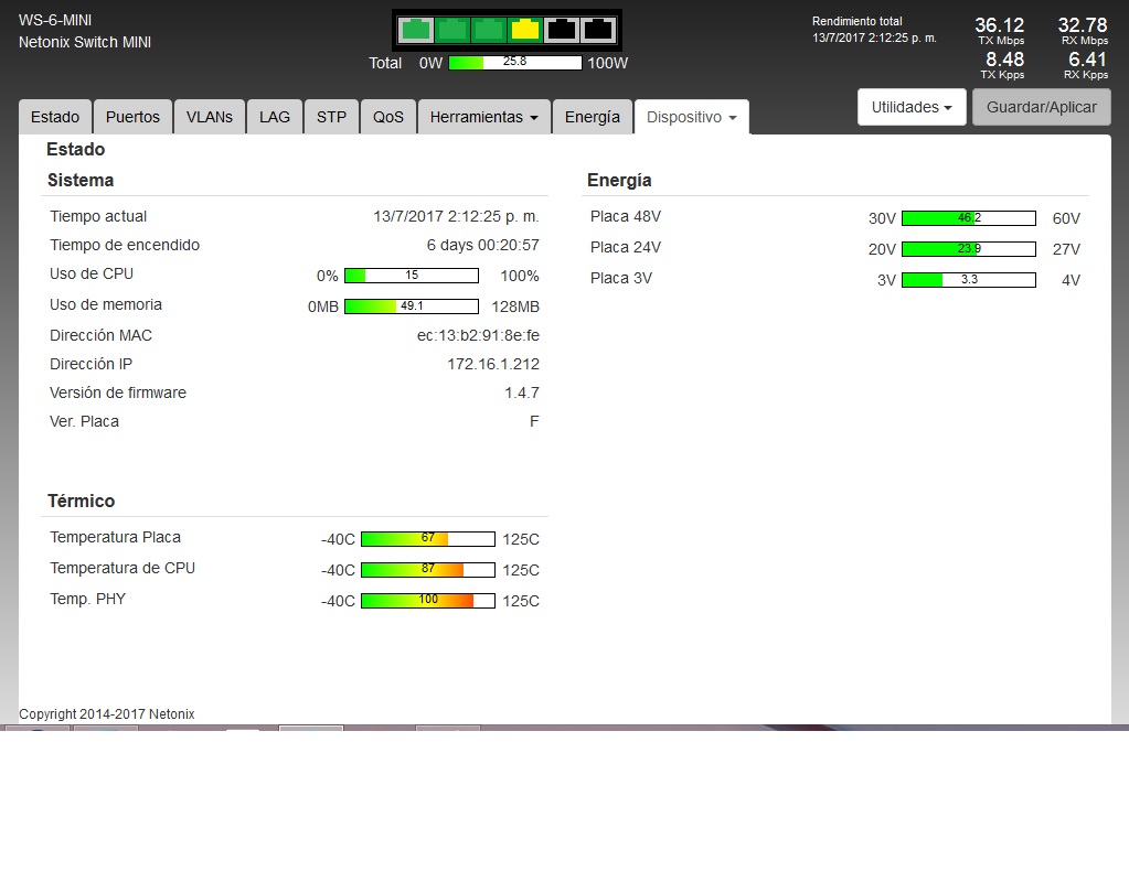

I am very interested in this post and check for a few days the temperature in which they are working my Netonix both are in the same box
They could have problems this units at this temperature or they would function normal I see that they are higher than they say that they support please confirm
Re: Mini 6 Max Temperature
jg0007 wrote:They could have problems this units at this temperature or they would function normal I see that they are higher than they say that they support please confirm
I am confused, why do you think they are higher than they support?
They support working in a 55C "environment"
The switches do not report environment temp they report "Board", "CPU", and "PHY" temperatures which look fine and will be warmer than 55C.
The CPU and PHY are rated to 125C and the board should be fine up to about 70C +/-
Of course the board, CPU, and PHY temps will be higher than environment temp, that is normal.
If you have a light bulb running in a room that if 55C will the light bulb be warmer than the room temperature? - Of course it will.
