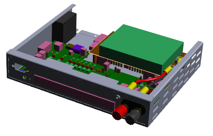

We have an 8 port coming out in December that is almost the same size as the ToughSwitch.
8 7/8" wide by 7 1/4" deep
There is a picture on here somewhere of what they will look like.
The Nice thing about them is all cables come out the front including AC socket so you can push the back against the inside of the box.
The sides need room for air vents and fan outlet.
This is a rendering of the 8 port DC version but the AC version is very similar
