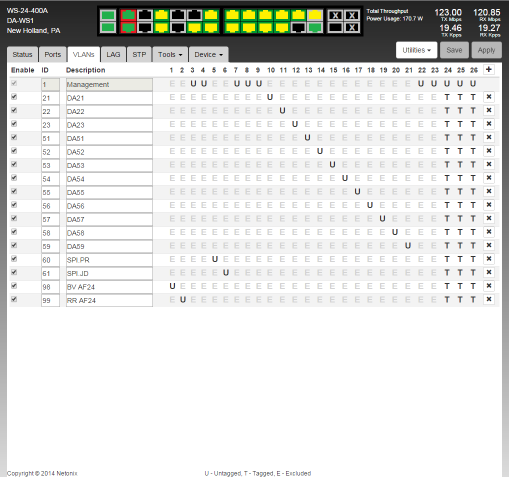

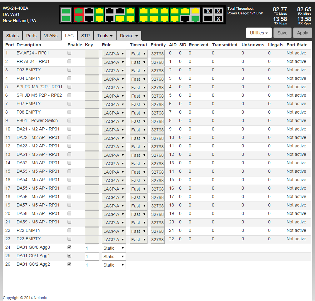

I know that Rory installed another switch at one of our tower sites late last night which is using is using the SFP ports that have a Static aggregation group to our Cisco router and it is also running VLAN's across them as trunk ports.
The aggregation group even goes one step further and includes 2 SFP ports (ports 25 and 26) and one copper port (port 24).
So our Trunk ports for all the VLAN's including the airFIBER back hauls are running across 2 of the SFP modules and ports 24 in a Static aggregation group.
When our SFP modules that match your fiber SFP modules get here we will determine if there is an issue with out switches working with them and if there is see if we can fix it or if it something else.
