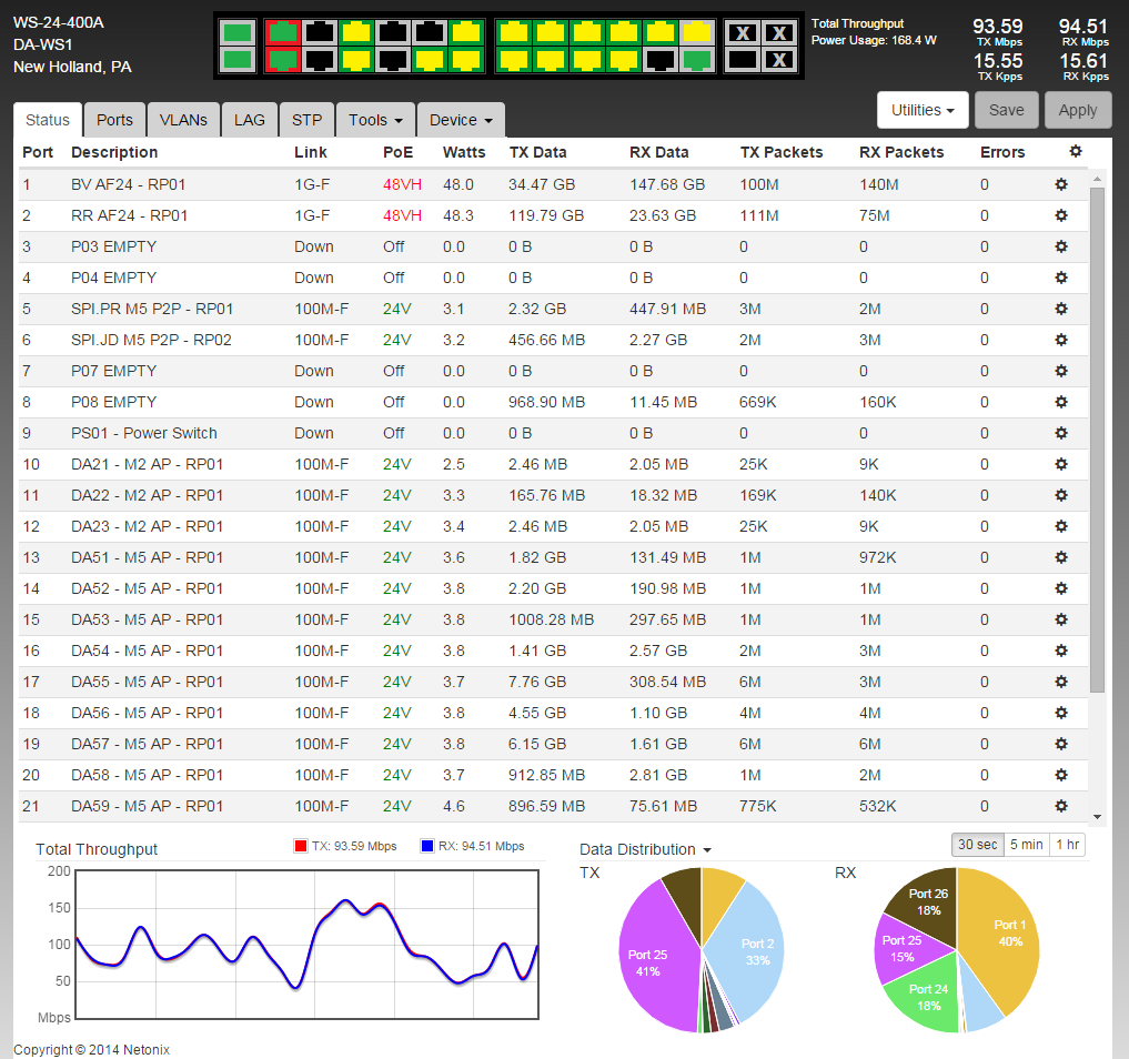

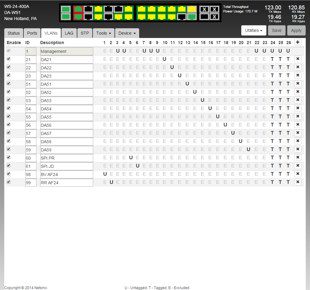

I know that Rory installed another switch at one of our tower sites late last night which is using is using the SFP ports that have a Static aggregation group to our Cisco router and it is also running VLAN's across them as trunk ports.
The aggregation group even goes one step further and includes 2 SFP ports (ports 25 and 26) and one copper port (port 24).
So our Trunk ports for all the VLAN's including the airFIBER back hauls are running across 2 of the SFP modules and ports 24 in a Static aggregation group.
