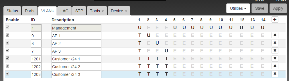

Lets say for example, I have port 1 connected to my router, running both tagged and untagged vlans.
Lets say I have three AP's connected to ports 2, 3 & 4 on the WS, trunked back to my router, using vlans, 9, 8 & 7. (every AP in it's own network) fine.
Now lets say I have VLAN's my customer traffic rides in. The CPE is immaterial, just assume it's tagging a VLAN up to the AP to get it's public IP. (see attached image)
The problem I have is the three customer vlans are now in what is basically a four port switch between port 1-4. So IF a customer on port 4 had their CPE in bridge mode and plugged in to their routers LAN port, a customer on port 2 requesting dhcp might get an address from the customer on port 4.
I want to be able to tell the tagged vlans on ports 2,3 &4 they can only talk to port 1 and not to each other.
I do this now using spit horizon bridging on mikrotik and it works awesome.

- WS VLAN Config.PNG (26.52 KiB) Viewed 47540 times
