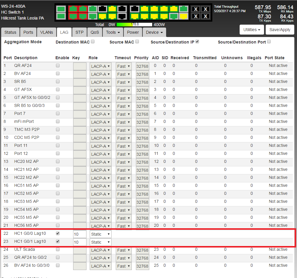

Cisco routers support Static LAGs but not LACP
We use a Static LAG between our Cisco routers and our Netonix Switches
Maybe Edge routers will support STATIC LAGs??

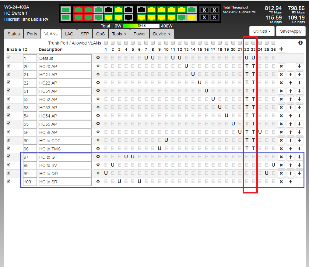

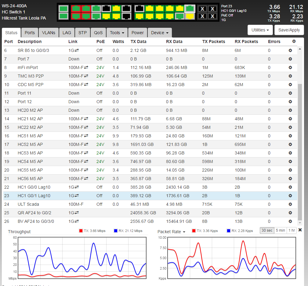

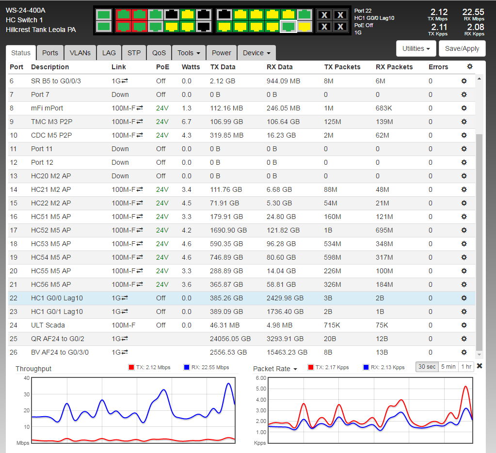

Here is our Typical tower Cisco config with a STATIC LAG

We do not have a switch card in our Cisco 2951 Mike99 and we set up STATIC LAGs with our Netonix switches?
Now the Cisco will not support LACP LAGs without a switch card.

Here are our Tabs in our switch
Re: Edgerouter Pro8 and Netonix Switches and Lag's
Notice the LAG carries only local radios to the tower such as APs and Private PTP to high end customers.
The back hauls go through the switch as 2 ports configured as midspan injectors.
This keeps pause framed from local radios from affecting traffic coming in and leaving the tower to the next tower.
This also allows us to reboot backhaul radios and see the traffic going through them.
Take a good look at our VLAN Tab and the Cisco Router config and it all lines up.
The midspan injector VLANs are in BLUE box all other local radios are feed through STATIC LAG from router. Works well for us anyway.
