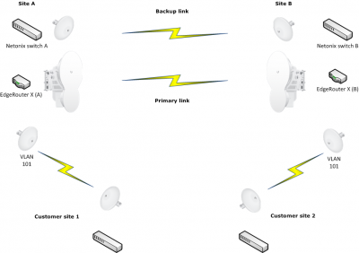

After upgrading from 1.46 to 1.47 firmware I'm having problems with this setup....
The switch port to both customer site A and customer site B has been set to Q on VLAN 101. Link (primary) between site A and site B has been set to T on VLAN 101.
After upgrade normal traffic between EdgeRouters on site A and B (running OSPF) has stopped. It's not working anymore, so I have lost contact to site B switch and router (I can ssh to router on link IP-address, both no OSPF traffic is passing, so no routes to site B.
What to do ?
What to do ?

Link between customer site 1 and customer site 2 is still working....

Several change have been made on QinQ between 1.46 and 1.47
viewtopic.php?f=17&t=2745
OSPF hello paquet seem to be block. I would try OSPF in broadcast mode if in multicast mode or vice versa. Also try point-to-point mode if not specified.

Re: Q vlan ?
Strange enough this issue got solved after rebooting both switches several times.
I don't understand, what the error is, but probably something in the EdgeRouters messed it all up. Eventhough not a single configuration change was made. Only change was the firmware upgrade...
