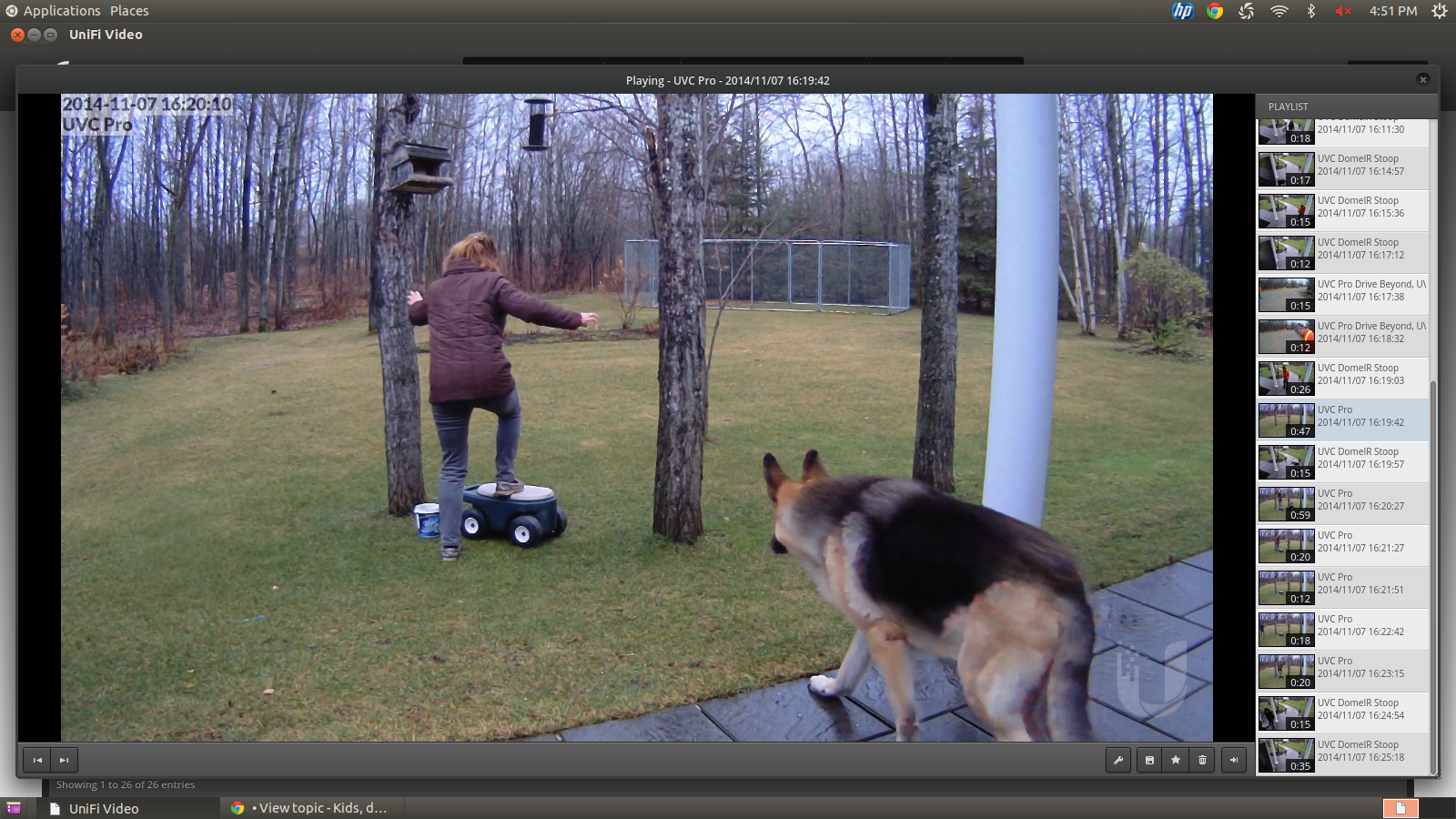

The following pic is from the UVC Pro that I mentioned in this thread. When I saw how the wife was about to use that rolling garden seat as a step stool, I thought to myself... Kids, don't try this at home. LOL
- Attachments
- Kids, don't try this at home
- Kids, dont try this at home.png (1.54 MiB) Viewed 31286 times
Re: Kids, don't try this at home
Nice! I take it and hope she lived through the experience?
Remind me not to break into your house, is that a puppy or a small horse? Is the puppy mean?
