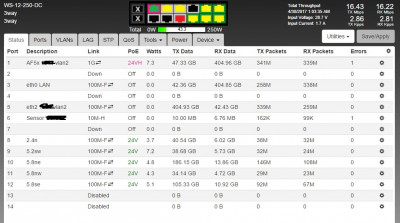

DC Switch 12 Port
Attached is a dc 12port tht has what it shows on it and the power if it helps you to compare how much it uses. This is at 1 am in the morning out in the rural areas. Approximately 70 subs on 4 RM5.s and 1 RM2. One AF5x backhaul.
Kevin

If that AFX radio on port 1 is a newer unit then you are better to power it with 48VH not 24VH.
To deliver 24V over 48V means an extra conversation and less efficiency.
Read this post: viewtopic.php?f=6&t=1215#p9040
After reading this post look at the MAC of the AFX radio and make sure 48VH is fine then change it if you can, its the smart thing to do.

Thank you for the information. My theory was that it would use less on the switch total input power. Gotcha, the AF is having to due (do) the 24v to 48v conversion then. I was thinking of the AF having to take the 48v and step it down to 24v. Thank you again and it will be changed now.
Kevin
