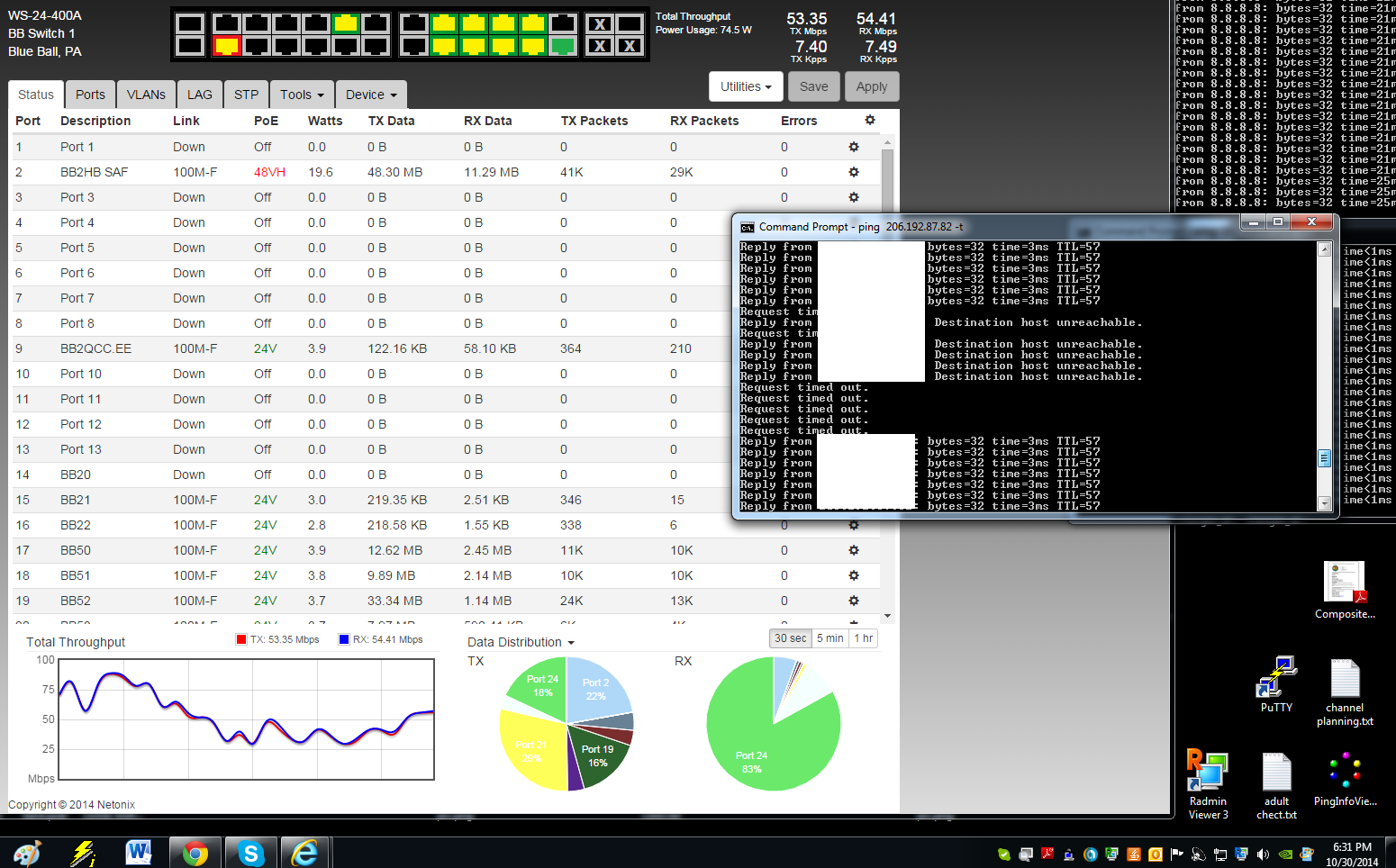

A tower upgrade
I just upgraded the tower WISP Switch that feeds my house (I am still at my office).
From v1.0.1 to v1.0.2rc3
Notice I only lost 13 pings from that tower!
Also notice that my ping times (3ms) to my house which travels as follow:
Through 2 WISP Switches here at my office
Through a Cisco 2951 for our office NAT
Through a Cisco 2951 at my office outside our NAT
1 mile fiber run to my wireless tower ring.
2 mile AF24 shot
Tower Cisco 2951 with a WISP Switch
3 miles AF24 shot
1 mile AF24 shot
3.5 mile AF24 shot
Rocket M5 AP 3 mile shot to my house NanoBridge
NICE!

Re: I am disapointed
I just got my switch this evening and haven't had any serious time on it yet. The first thing I did was to upgrade it to the latest (1.0.2rc3) and it hung on reboot so I had to pull the plug on it.
Just placed on management vlan and testing cables to router. I will be upgrading firmware and moving my Airfibers over to them this evening :)
I was using Chrome. I spawned another browser but it would not connect. The link port on the TS8 showed link state. Tried pinging the WS24 from the TS8 and it timed out.
After the hard boot, I tested the reboot option from the UI and it worked. Tested ping as well from the TS8 and it responded.
Well firmware completed dropped about 5 pings but interface came back without issue. :)
