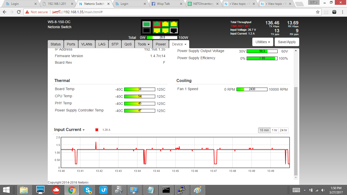

Hello. We deployed our first WS-8-150-DC switch and is is being powered by a Meanwell AD-155B power supply.
We have the load voltage set to 27.0 volts as shown in the screenshot but when I look at the input current graph, I see it dip down from about 1.5A to less than 0.5 A about every 3 minutes. Is this just a bug in the graph or something more I should be worried about? The reason I think it may be a bug is when it dips way down, it has a flat line instead of showing more detail like when it is operating normally.

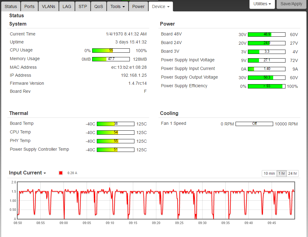

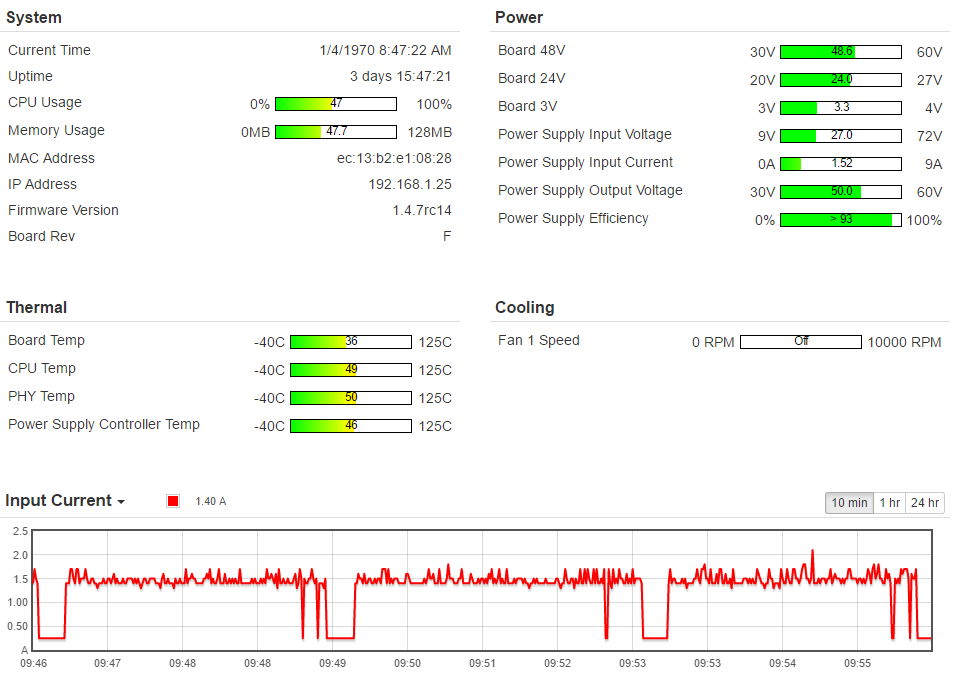

Also, when the graph shows a flat line, the input current shown at the top with the gauge shows the normal 1.4 to 1.5 A. I've attached a screenshot showing this behavior as well with the graph not showing what the other indicator shows on the same page.
Let me know if this is a bug in this RC firmware. Thanks
Weird input current graph

Julian reproduced this in v1.4.2 now he is trying v1.4.6rc14
He will then confirm it there and if it is there he will get Eric to fix in next release

BUT back to your initial post, you have found a bug and this has been passed to Eric and will get fixed in the next release....thanks and sorry for the issue.

Okay, so couple observations:
When the low points on the graph are being drawn, the stated value for input current does not change, which tells me it's a graph-scaling issue rather than a sensing issue; In simpler terms, the picture isn't an accurate reflection of the power state. Will try to get a screen capture to show this, but the good part is that SNMP monitoring will return the correct value of ~1.2a.
