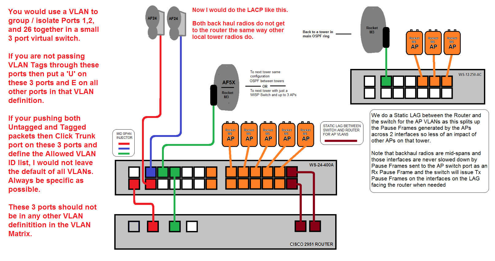

Something like this is what I would do

Re: LAG microwaves
Hello.
I have always a question with this, the radio must be really transparent for the switch? For example like AirFiber with one port for data and the other for management.
Or can be any Rocket or other that has management and data on same wire?
I think that the link between the two switches must be really transparent like two wires.
Re: LAG microwaves
CuninganReset wrote:Hello.
Yes it must be a true bridge LACP, a Static LAG is not as picky but can not deal with one link dropping out like LACP can.
