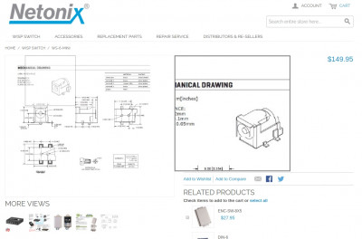

After searching, I couldn't find the answer to this question?
What is the correct dimensions for the power plug on the WS-6-MINI switch ?
I for one, would be more than willing to pay a few more bucks for this switch to include the proper power plug in the box with it !
Thanks,
Wayne
WS-6-Mini power plug
- Posts: 168
- Location: NC USA
- Has thanked: 362 times
- Been thanked: 87 times
Re: WS-6-Mini power plug
Had to search on "barrel connector" and scroll a bit, but: viewtopic.php?f=17&t=722&hilit=barrel+connector&start=10
EDIT: See also the mechanical drawing here https://www.netonix.com/wisp-switch/ws-6-mini.html
sirhc wrote:Well they sayOutput : DC 48V 2A / 2000mA 96W
Out put adaptor jack size 5.5mm x 2.5mm
the adapters Connector inside positive (+)outside negative (-)
So Polarity is correct, center pin (+)
And our center pin requirement is 2.5mm
Should work.
Or you could just click on the image in More Views.
