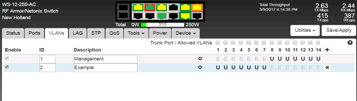

If you can not quite get your LAB to work right then post up a screen grab of your VLAN Tab with a detailed description of desired behavior with a diagram showing your equipment and how you want the VLANs to segregate your traffic.

If you want my help then put up a VLAN screen grab, a diagram of what you want to happen along with a detailed explanation of what is not working the way you think it should.
You have not even given half the information needed to give you an answer anyway.
As an example below is an example of breaking a switch into 2 logical switches:
Logical Switch 1 Ports 8-14
Logical Switch 2 Ports 1-7
Devices in ports 1-7 can not see or talk to devices in ports 8-14 and vice versa
But you could also not reach the switch UI or CLI from ports 1-7 as the switch only responds to the Default VLAN which is the VLAN at the top of the list, the one you can not delete and it has all "E"s for exclude on those ports. (The switch only responds on the Default VLAN)
Also the example below would not accept any Tagged packets, only Untagged packets.
If I changed all the "U"s to "T"s then ports 1-7 would only accept packets with a VLAN ID Tag of 2 and ports 8-14 would only accept packets with a VLAN ID Tag of 1.
Then with "T"s instead of "U"s in both cases the packet would leave the port with the VLAN Tag intact since the egress port also has a "T".
The switch UI could only be reached on ports 8-14 with packets with a VLAN ID Tag of 1 destined to the IP of the switch UI/CLI.

sirhc wrote: In both cases the packet would leave the port with the VLAN Tag intact since the egress port also has a "T".
bhesterberg wrote: In your pic, none of the ports are Tagged(T). So which port is the egress port?
Well you obviously did not "fully" read my post above.
sirhc wrote:If I changed all the "U"s to "T"s then ports 1-7 would only accept packets with a VLAN ID Tag of 2 and ports 8-14 would only accept packets with a VLAN ID Tag of 1.
Then with "T" instead of "U"s in both cases the packet would leave the port with the VLAN Tag intact since the egress port also has a "T".

- Ingress packets: Encapsulate packet inside a VLAN Tag. If an Untagged packet it simply adds an outer VLAN Tag but if already a VLAN Tagged packet it encapsulates the packet inside another VLAN ID Tag, this is why it is called "QinQ", a packet inside and 802.1Q capsule inside another 802.1Q capsule, get it, QinQ
D = Double Tagged
This is a new feature people asked for and I have not used it but you could do searches on the forums and read about it. You could use advanced search for post by our programer "Eric Stern"
I did a quick search for what the D will do and found this post by the programmer Eric with an example:
viewtopic.php?f=17&t=2357&p=17815&hilit=Double#p17815
You can only have one "U" or "Q" assigned to any one port no matter how many VLANs you define.
Then there is an option called "Trunk Port / Allowed VLAN List" which allows you to specify ranges of VLAN IDs accepted on a port. Trunk port is really an incorrect terminology but we kept it so people used to using the ToughSWITCH UI would feel at home.
Our ingress filtering is specific meaning if you do not specify exactly what a port should except it will reject the packet. Some switch manufacturers will dumb this filter down which allows incorrect configurations to work or at least appear to work but in reality traffic is not properly being segregated which is WRONG and poses security holes but it creates less tech support because to the user it appears to work but in reality it is not segregating all traffic properly they simply think it is working so it must be correct......NOT.
The default or management VLAN is the Top VLAN and can not be deleted. This is the only VLAN that the switch UI / CLI / SNMP / ETC will respond to. You can not delete the default VLAN but you can renumber it (Change the ID) or rename it. You can not make the switch UI/CLI respond to any other VLAN. Some switches allow you to specify which VLAN is the Management VLAN we simply force you to use the top VLAN as the Management VLAN but instead allow you to rename and renumber it's ID which achieves the same ends.
There are many posts on this forums where we discuss VLANs which you can search for and read through but we follow the industry standard so if you understand VLANs the only other thing you need to master is the UI which is pretty straight forward and made simple.
Now since we simplified the UI we did take some granular configuration abilities away but unless you are a master at VLANs you will never need them or understand them anyway and even then if you are a master and fully understand VLANs there are ways to make our UI provides most if not all of those granular abilities.
But everything I just retyped in this post can be found on several other posts throughout our Forum if you simply search for them.
T = Tagged
- Egress it leaves VLAN Tags alone
- Ingress it only accepts VLAN ID Tags that match that VLAN definition or other VLAN definitions with a T on that port or looks at the Trunk Port / Allowed VLAN ID List for that port if enabled
U = Untagged
- Egress it strips all VLAN ID Tags and sends packet on its way as a non VLAN Tagged packet
- Ingress it only allows non VLAN Tagged packets in unless another VLAN definition has a T on that port then it would accept Untagged or Tagged packets matching the VLAN ID of another VLAN definition with a T on that port or if the Trunk Port / Allowed VLAN List is selected then the IDs in that list
E = Exclude
Just what it says it does.
Q = QinQ
- Egress packets: Strip outer VLAN Tag but leaves any inner Tag intact if it exists. If no inner VLAN ID Tag exists because it is just a standard VLAN Tagged packet then the packet becomes an Untagged normal Packet.
D = Double Tagged
