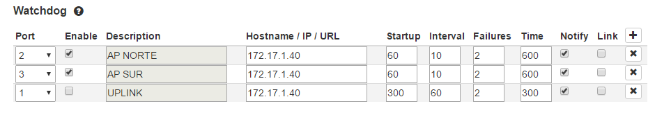

What i did now, i configured the whatdog as this:
With this configuration i ensure that the AP will not radiate SSID and reboot it before any client connect to this AP.
¿Can you develop this tool or do you think is not needed?
