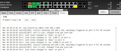

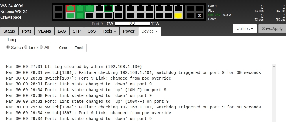

Re: Ping watchdog that power off AP until uplink restored.
Eric Stern wrote:Actually, I think you can do it with the ping watchdog as it is if you set "Interval" to 30 seconds and set "Time" to 60 seconds and "Failures" to 1...
Did you test it? I just now tried using the IP of my phone as the watchdog on a Pico. When I turn off the WiFi on the phone, the Pico goes down but does not stay down.
