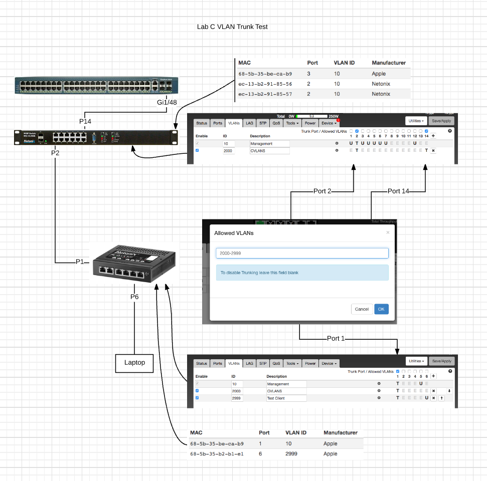

Re: Port Disabled (Not in any VLAN)
Lab setup attached. I changed the VLAN range for my lab. Note that the client mac on VLAN 2999 does not pass from the WS6 to the WS12.
In this example, I get rid of the trunk vlans checkbox, and add customer VLANS to the WS-12. Note that the customer MAC on vlan 2999 now populates the mac address table on the WS-12 and the BNG mac also populates on the WS-12 and the WS-6.
Obviously, this won't scale as one would need to manually enter 1K vlans.
