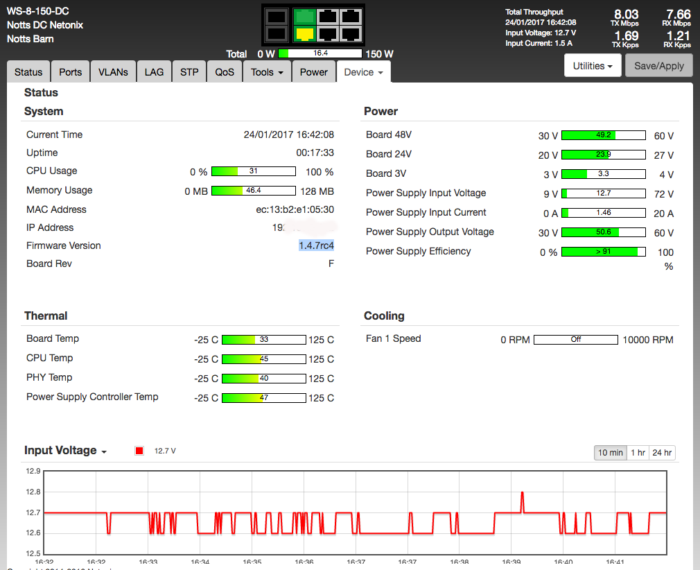

This morning ( -3 C) we had one warning email for 11v and WS-8-150-DC 'died' or should I say was not contactable remotely in spite of the Powerbeam still contactable/working. Went up and found the volts were 11.7 (photograph of volt meter in box) but NO lights on the WS-8-150-DC . Changed the batteries and saw the LED's glowing on the LAN outputs and I think the 'master' LED on the WS-8-150-DC (sun shining on it). Saw we had output on the Rocket (on phone). Went away

I understood the WS-8-150-DC would work down to 9V.
Further I assumed it would still contactable down to that voltage, is it possible I have misconfigured something?

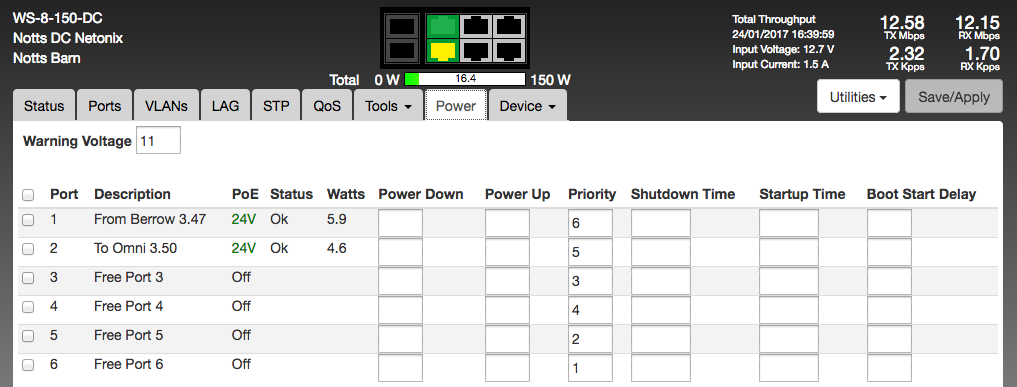

The configuration I did was to change the order of priority to keep the Powerbeam up and put a warning voltage of 11V NB it was set to 10.5 v the first time it cut out.
I seems to me that this WS-8-150-DC stops passing traffic at about 10.5 -11.v. and maybe comes alive again at 12.5V - 14V.
