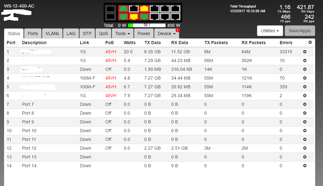

I'm having a strange issue at a new tower site. For some reason I'm getting errors on ports and two devices (both AF-5X) are only linking up at 100 mbps.
The cabling is Toughcable Carrier and all the lines pass a cable test with a Fluke. What's interesting is that the SNR readings from the AF-5X's show 29 db on every pair, which should be good.
What could be causing this?

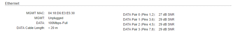

Re: Radios Not Linking at 1 gbps
Here's the other thing. How come your cable test shows that pair 7/8 is 1 meter long yet the two AF-5x's show a SNR on that pair?
- Attachments
- image1.png (7.75 KiB) Viewed 23316 times

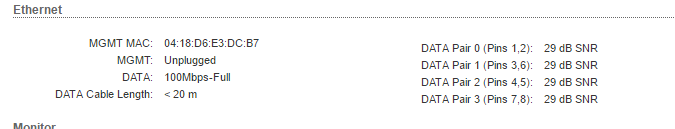

Here's the other.
- Attachments
- image2.png (7.96 KiB) Viewed 23316 times
