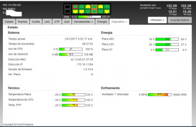

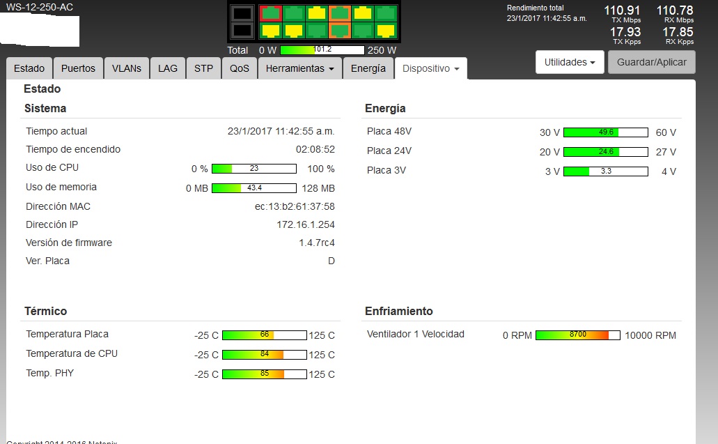

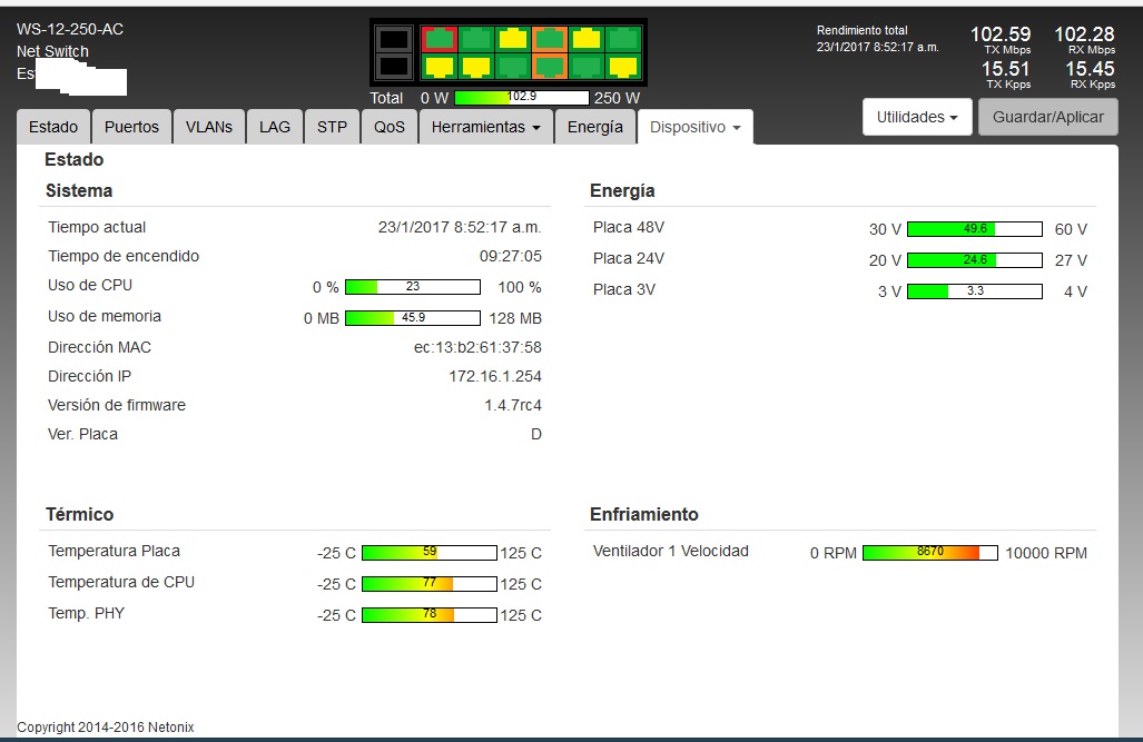

Thanks for replying I'm not using UPS
This direct from the inverter
Update to beta firmware continues with reboot

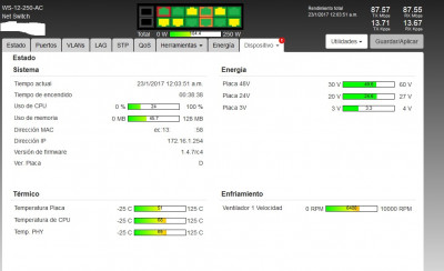

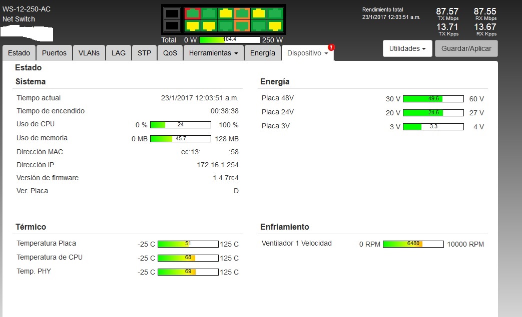

Sirhc the problem persists already restarted again I send another photo
Do you have any idea how to solve this problem
How can i solve this problem

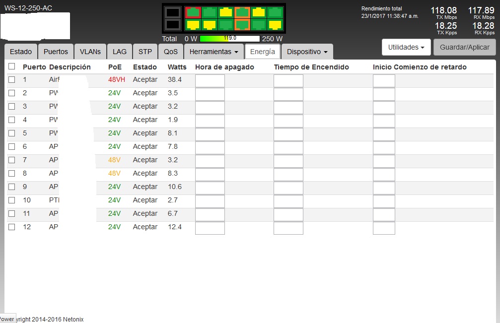

Once again blocking out the Names on the Ports is counter productive for me.
Do you not think that the port descriptions telling me what device is on that port could be useful to me?
How is letting people know what type of device is on what port is a security hole? But it does let me see what the device is and I can see if the watts being used are reasonable for that device.
I am still going to say your inverter is insufficient and the power is dipping causing the switch to reboot or you do not have the tower grounding bonded to the electrical service grounding and the Ethernet cables are carrying excessive ground current..
