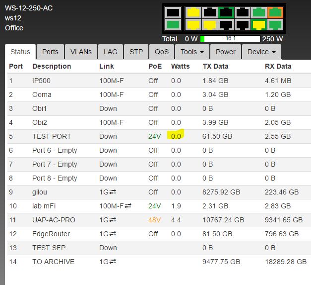

Out of curiosity I powered a dongle up with nothing attached, and it shows 0 watts.
So the device itself does not have a draw until there is something connected.
- Code: Select all
Mar 13 11:02:54 ws12.jakematic.lan UI: Configuration changed by admin (192.168.0.141)
Mar 13 11:02:54 ws12.jakematic.lan UI: Port 5 PoE: changed from 'Off' to '24V'
Mar 13 11:02:57 ws12.jakematic.lan switch[1359]: PoE enabled on port 5, PoE Smart is starting cable check
Mar 13 11:03:02 ws12.jakematic.lan switch[1359]: Port 5 cable check results: Open, Open, Open, Open
Mar 13 11:03:02 ws12.jakematic.lan switch[1359]: Port 5 passed PoE Smart cable check, turning on power
Mar 13 11:05:12 ws12.jakematic.lan UI: Configuration changed by admin (192.168.0.141)
Mar 13 11:05:12 ws12.jakematic.lan UI: Port 5 PoE: changed from '24V' to 'Off'
This is the device I'm using: https://find-a-poe.com/product/PoE-for- ... %28Male%29
