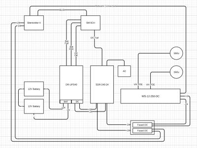

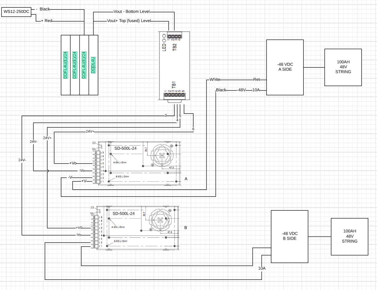

We use the DR-RDN20 for redundant power. At our -48V core sites, we feed them with DC-DC converters like in the attachment.

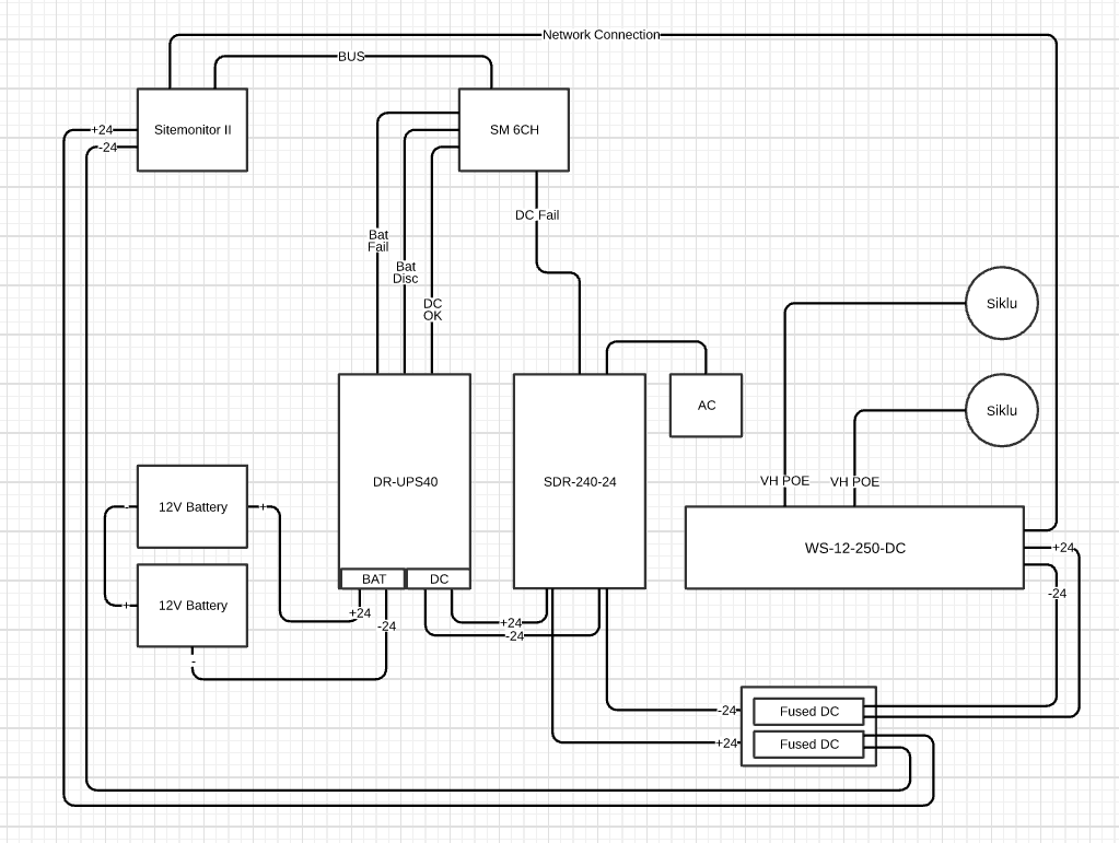

At our 24V mini-pop sites we use the DR-UPS40 and appropriate SDR Power supplies. Our 24V sites are generally low power with a Siklu in, a Siklu out, a Netonix switch, and perhaps a local PMP AP. Note that the 24V site diagram doesn't show redundancy, but you would just add a RDN20 and another PS or PS, DR-UPS40 and another battery string.

+1 for the 24 volt design, we use almost the exact same thing. Been very stable. Our only difference is that we use 2 banks of 24 volt batts in parallel but fused separately. Mouser has the parts.
