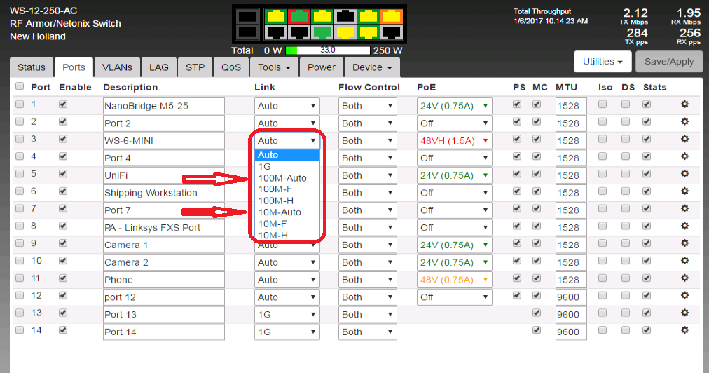

The RM5Ti is known to have issues when left to autonegotiate a gig link and the proposed workaround is to force it to 100 meg.
What is needed is an option to limit the autonegotiated speed to 100 meg rather than hard code it. ISTR that feature was requested. Do you recall if it is on the roadmap or not?
You could try doctoring the cable to force the autnegotiate to fail at gig by shorting one of the power pairs such as pins 7&8.
Re: ROCKET TITANIUM XW PROBLEM
lligetfa wrote:What is needed is an option to limit the autonegotiated speed to 100 meg rather than hard code it. ISTR that feature was requested. Do you recall if it is on the roadmap or not?
Hey Les, that was added a long time ago.
