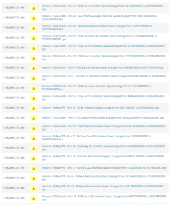

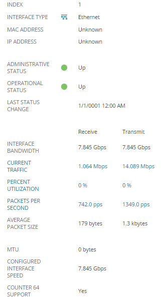

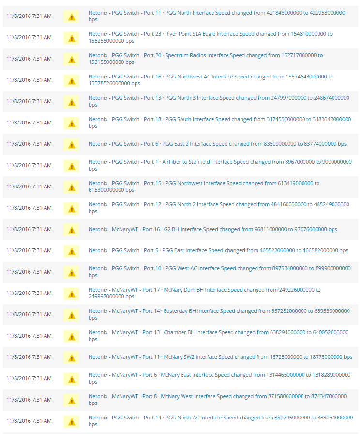

I have Solarwinds deployed and since updating to firmware 1.4.5rc7 the Netonix switches are reporting their interface speeds to be 7Gb. Then on the next poll the interface speed will change to 78Gb or some other random number. This is causing my event logs to fill up on the server because we have multiple Netonix switches.

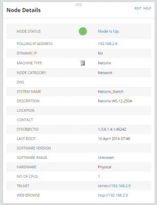

Also another issue I noticed is that the "Last boot" date keeps changing but its actually not rebooting..
So basically I am having an issue with SNMP not reporting correctly after the firmware update.

Here is some more info on what the Event logs are showing in Solarwind. The interface speeds are changing to all sorts of random numbers.

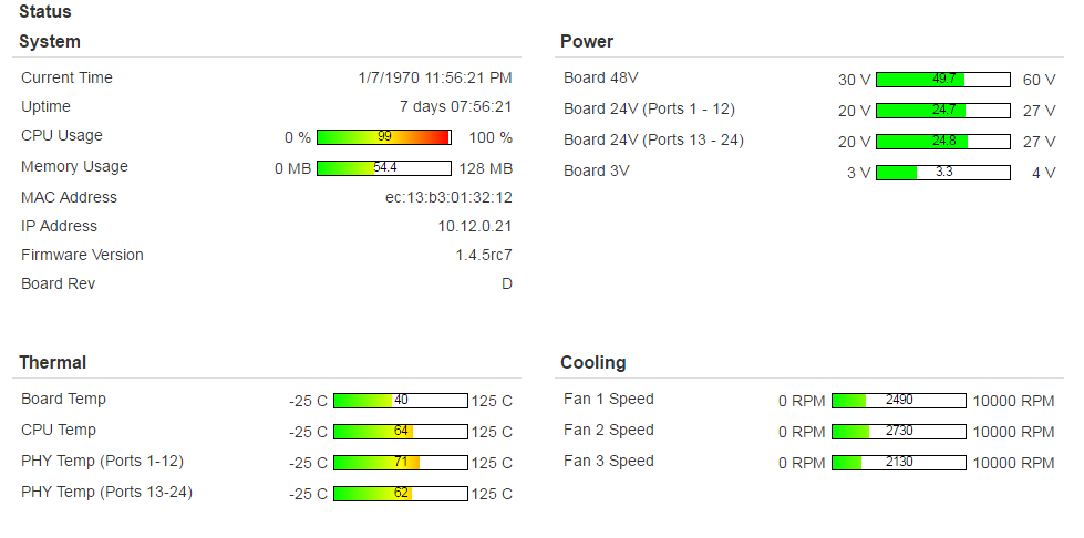

I just noticed also the CPU seems to be spiking up to 99% as well.

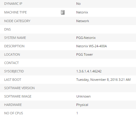

Also here is a screen cap showing last boot time that is being reported to Solarwinds but in the screen shot above you can see the system has been up for 7+ days.
