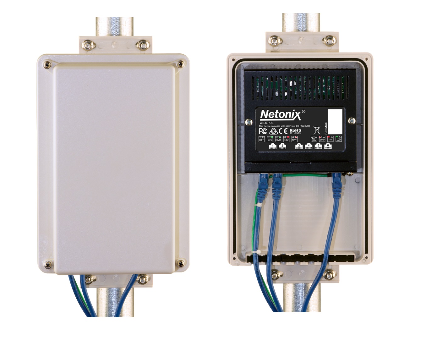

Why not put the WS-6 MINI on the Roof in a Tycon box then run a single wire into the house and power the WS-6-MINI with an AF24 POE brick supplying power to the WS-6-MINI via POE IN on its port 1 and then plug the customers wireless router in to the AF24 POE brick on the LAN side.
Then the WS-6-MINI can power up to 5 radios on the roof
Similar to below:
