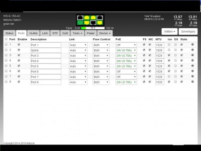

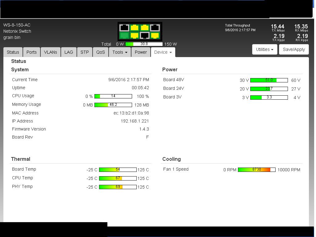

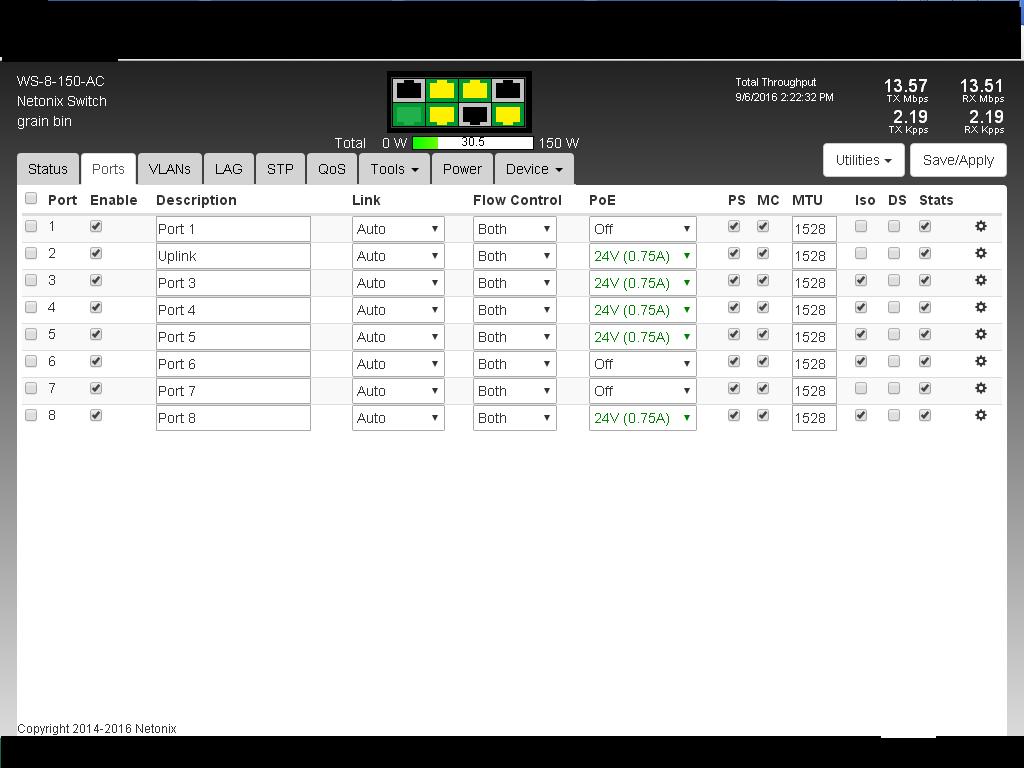

I would like to help so here is what I would like you to do so I can help:
1) Upgrade to v1.4.3
2) Post up a screen grab of the Stats Tab and the Device/Status Tab and the Ports Tab
To up load screen grabs of the Tab use the upload attachment under the BLUE SUBMIT BUTTON and then place in line

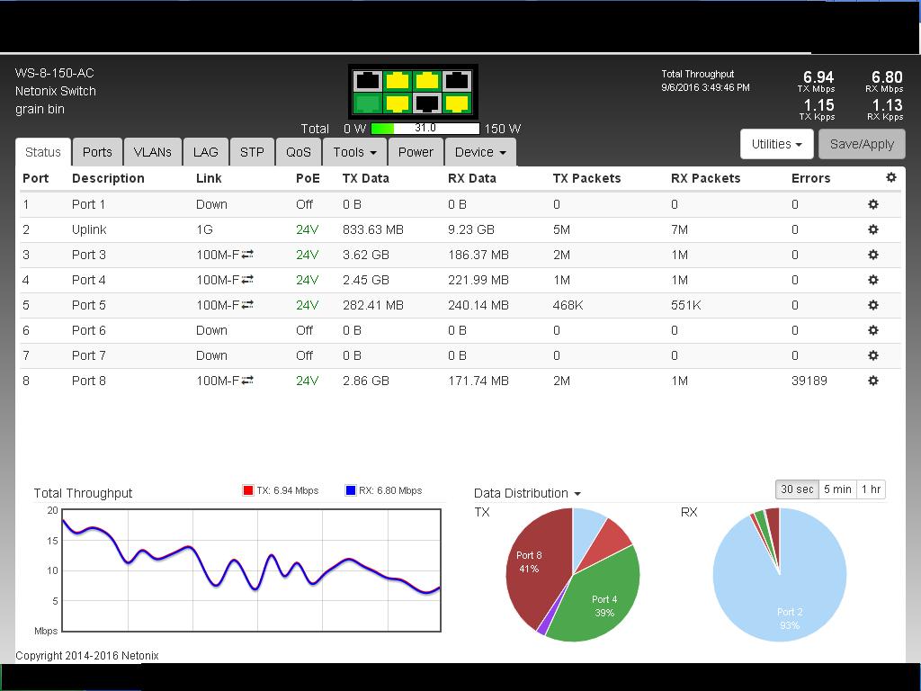

Attached.
Update -- I had to force the RocketM2 to 100FD and the port to 100FD to stop the errors.

Re: Constant "set port forwarding / learning / discarding"
@intercept
Well holly crap man look at the errors on port 8, your link is dropping which is causing the RSTP issue you see in log.
One of these is your problem:
1) Port in switch is bad - Test by moving to port 7, if problem follows cable then not the port.
Although it could be the end on the cable in the port 8 and re-seating it fixes it.
2) Cable Ends = Replace ends
3) Cable is bad = replace cable
4) Radio is bad = replace radio
You could disable RSTP on port 8 but that just hides the problem.
Could also be ground current on this cable, are all these radios on the same tower and close to each other?
Is the tower grounds bonded to the electrical service grounds?
By the way v1.4.4 was release so upgrade!
