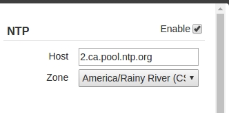

anybody in CDT zone have a switch that keeps time? plz post picture of your NTP setup. thx

I am in Canada.

by CharlesA920
Thanks, that worked on one of my switches.
There were a few more i put in the same info but they still have "time not set"
not quite sure what's up with that.

by Mad Dog
I got mine working throughout the whole network last week. I used the IP address of ubiquity's NTP server as the Host 45.127.113.2 with the Zone set as America/Chicago.
