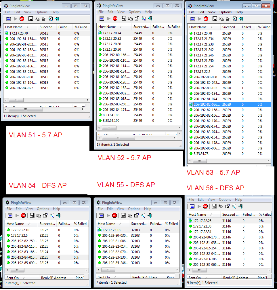

But as you can see in the picture below I ran the switch all night and we only lost ONE ping to a customer when using only ports 1-12.
When using the TS we lost a considerable amount of pings, mind you less than 0.01% on average but our switch appears to preform much better but one would assume this since the TS BCM53118 switch core was meant for small home or office environment and our core was designed for enterprise.
Now the edgeMAX has a core that is also suitable for Enterprise installations as well and the way they implement the feature is a better solution for an Enterprise deployment but we feel ours is better for tower locations because of the higher operating temperature and the fact that we did not allow all the advanced Enterprise features that 99% of WISPs do not need at a tower site and just make the configuration more complex.
vlan pings.png (103.33 KiB) Viewed 34632 times
