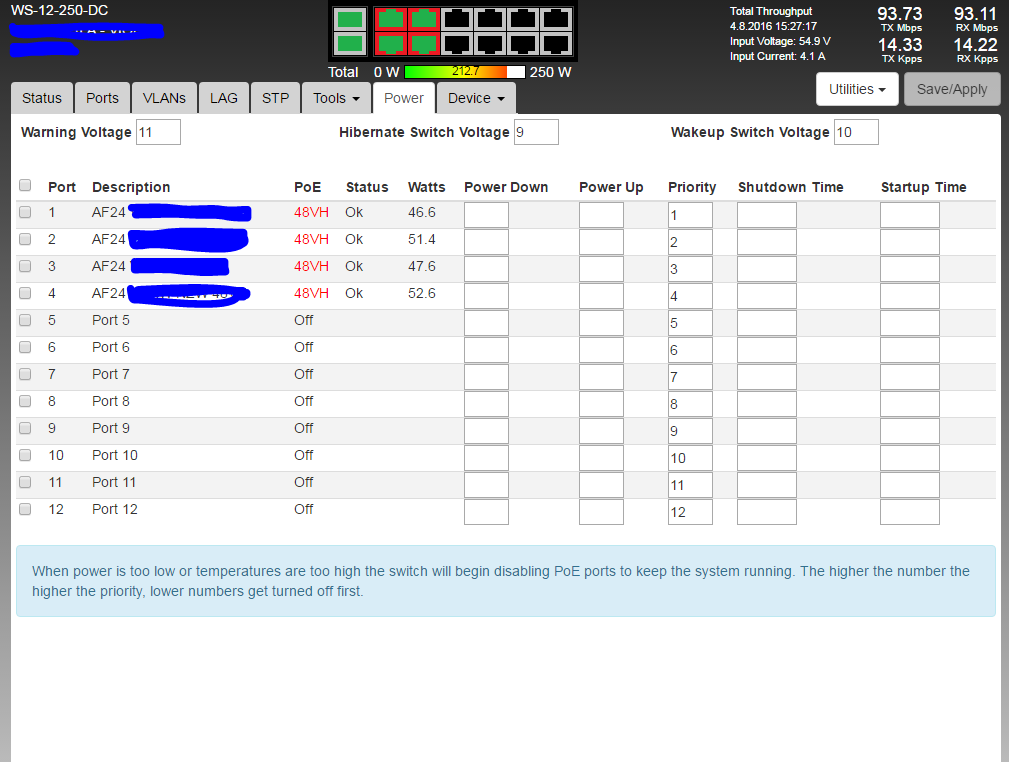

Please update the picture of the Power Tab, I need the top input values on the power tab you cut off such as hibernate
Also on at least one picture show the top portion of the screen with the switch graphics
By the way you can upload pictures to the forum, look for the link "Upload attachment" next to the BLUE Preview and Submit buttons

Oh, so i attached the updated image of the power tab.
