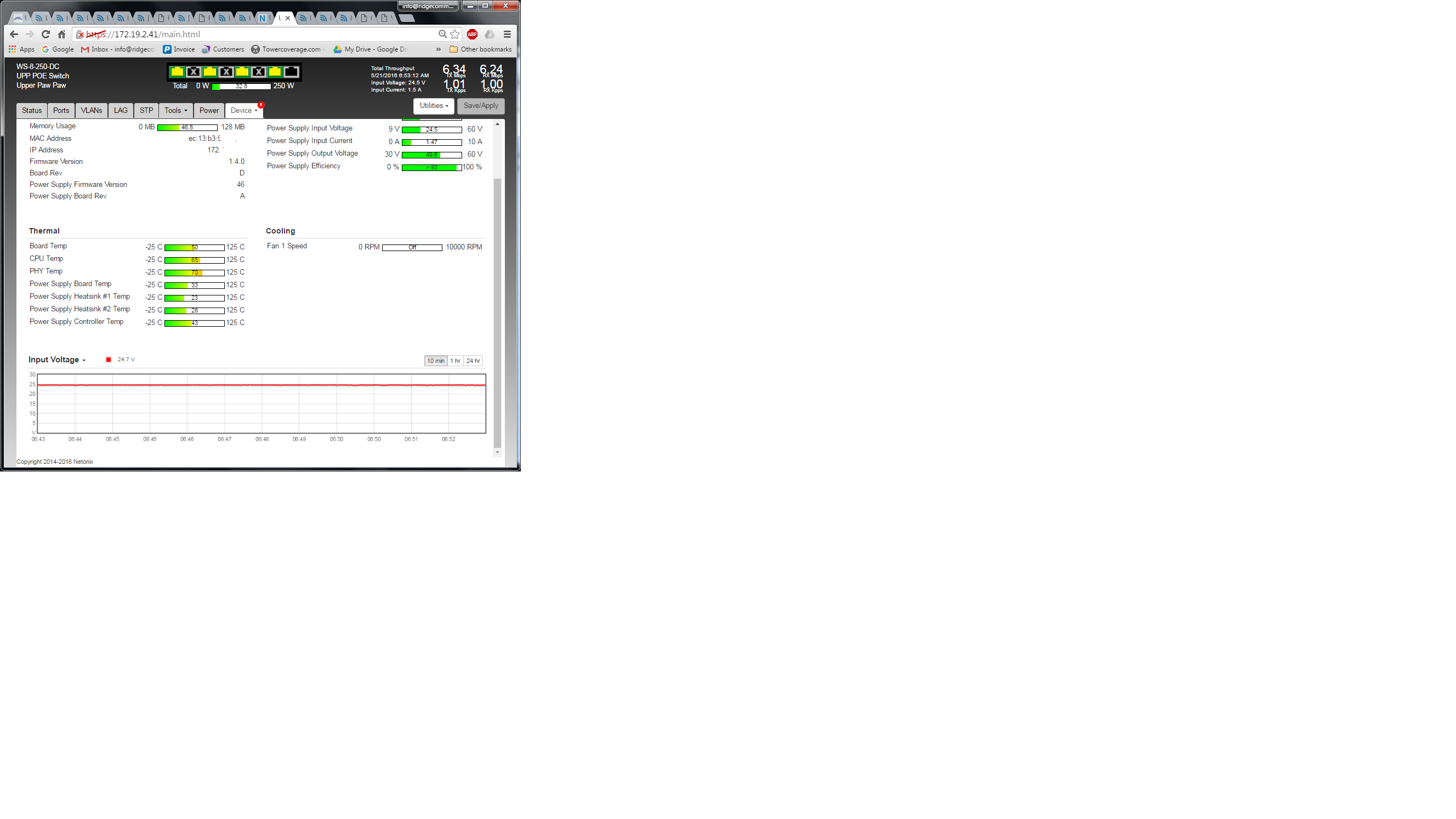

Post up your Tabs in this post so we can all see your config tabs to brain storm.
Primarily your Status, Power, Device/Configuration, and Device/Status as we are not interested in your network that is not the issue.

Re: WS-8-250-DC rebooting
Your going to have to dig a little and find out why.
Does it reboot at the same time every night?
If so login to the unit prior to the known time of reboot and watch the stats or be on site.
Setup a syslog server so you can review the logs prior to the reboot.
Maybe tell us a little about the site:
What is powering the switch?
How many volts?
Post up screen grabs of the Tabs.
