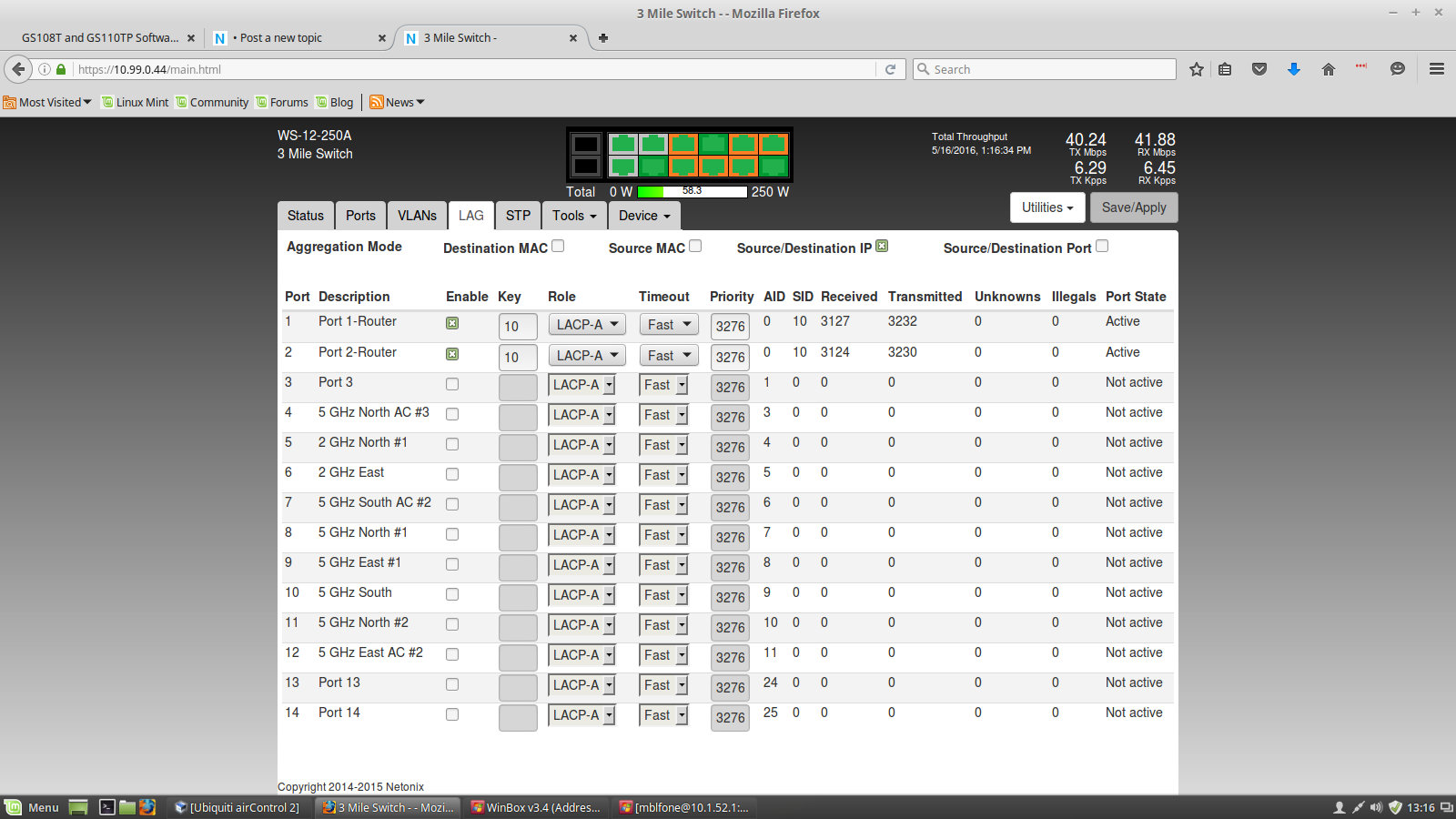

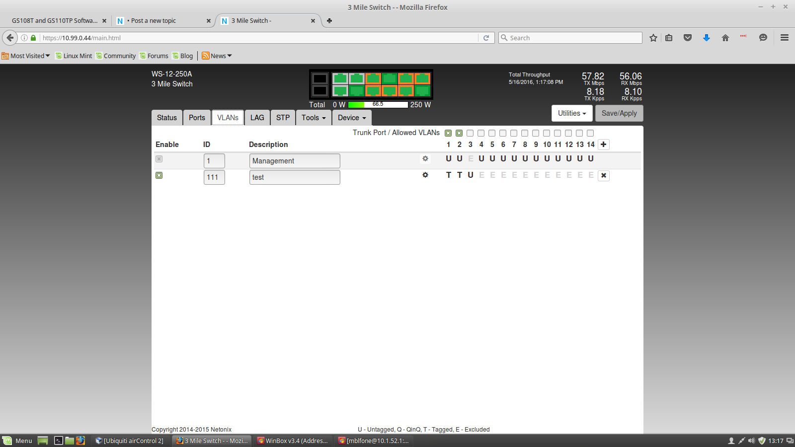

Hello,
I have been struggling to get VLANs to work on bonded interfaces. I have a Mikrotik Cloud Core router connected to our Netonix switch with a common bonded interface. That works great with untagged traffic. When I try to assign a VLAN ID of 111 as a VLAN interface attached to the bonded interface on the Mikrotik and set the Netonix similar to SIRHC's "This works well for us", I can't get VLAN traffic to pass. I have posted the applicable MT code below with Netonix screenshots. Port 3 on the Netonix is plugged into a laptop with the IP of 10.50.0.13. My test is to ping 10.50.0.1. This DOES work if I use a non-bonded connection between the MT and the Netonix. Netonix firmware is 1.38, MT firmware is 6.35.2.
Any thoughts are greatly appreciated!
Scott

Re: VLANS, bonded interfaces, Netonix and Mikrotik
Scott, are you still working on this? I tested this configuration between two Netonix switches and it worked ok, so in general it should work. According to the screenshot the Netonix believes the LACP link is running (both ports are Active), maybe check if the Miktrotik agrees.
I do have a Mikrotik around here somewhere, although its not a Cloud Router, so if you are still having problems with this I can try to dig that out and give it a try.
I think you missed a step on the Mikrotik. This is what I had to do on mine (RB2011UiAS-RM) to get it working.
In this setup I had my laptop (configured for vlan 111) on ether3. ether4 and ether5 are the LACP ports going to the Netonix switch which is configured as you have shown above.
I used the GUI to configure it, but I believe these are the equivalent CLI commands.
Eric,
Activating Multicast on the Ports tab did indeed fix this issue which is now closed on my end.
Thank you very much!
