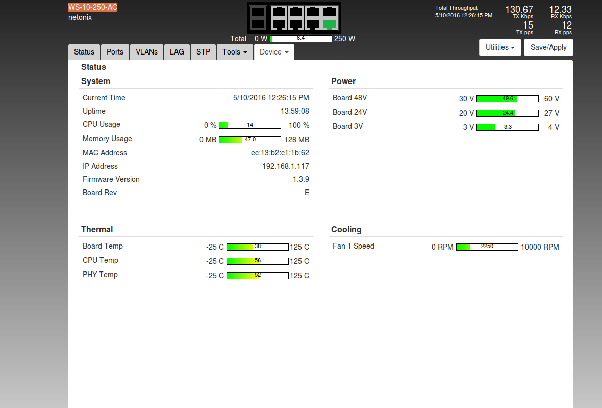

Just received my WS-10-250-AC and started configuring it. One thing I noticed is that it is running pretty hot even without a load or traffic. The CPU temperature ranges between 50C - 60C with ambient temperature ~70F/21C. The fan cycles on and off every 8 minutes.
Is this normal?

The switch core (CPU/PHY) are rated to 125C your switch is not running hot.

sirhc wrote:The switch core (CPU/PHY) are rated to 125C your switch is not running hot.
What happens when temp reaches or exceeds 125C? I have a WS-6-MINI that is mounted in an attic. Yesterday afternoon when it was 87F outside, the switch did something very strange. 1 of the ports shut down completely (the POE IN port) but power stayed on to the switch, just no Ethernet link. A 48V port turned off, another 48V stayed on and passed traffic and a 24V port stayed on and passed traffic.
After bout 30 minutes of this behavior, it looked like it reboot and came back to life normally.
I know an attic space is not ideal for a mounting location but I figured it couldn't be worse that putting a WS-6-MINI in that small plastic enclosure with no air flow and attaching it to a tower.
Right now, at 81F outside, the board is 73C, CPU is 99C and the PHY is 103C.
Re: Wisp switch temperature
cwachs wrote:I know an attic space is not ideal for a mounting location but I figured it couldn't be worse that putting a WS-6-MINI in that small plastic enclosure with no air flow and attaching it to a tower...
I think a small grey plastic enclosure would be much less of a solar collector than a large roof surface.
