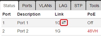

Well my first question would be is Flow Control indicated as active to the EdgeRouter on the Status Tab? We know UBNT has been working on Flow Control with their routers and some radios.
Port 1 shows Flow Control Active
Port 2 shows no Flow Control Active
