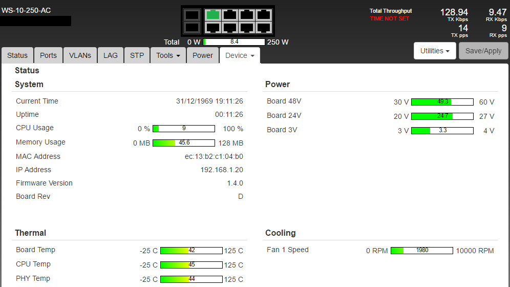

I just received the WS-10-250-AC and I'm surprised by how much the fan stays on (all the time).
Are there SSH commands to turn the fan on / off or can we at least customize the temp range where they kick in?
I just plugged it in for first time and its running at 2000rpm without any PoE load, room temp is 24c
I'm wary about putting it into a sealed enclosure aswell as draining my UPS battery quickly.

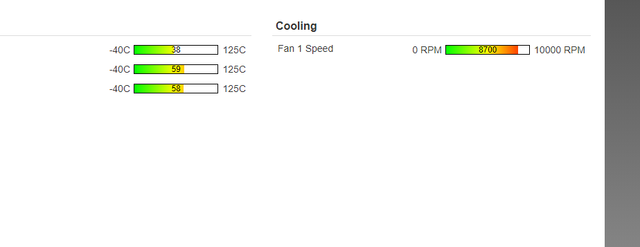

Hello, I am using a 250-AC in an office environment for setting up other devices. My question is this. Why do my fans when they do come on go to 8700rpm for a few seconds then kick of then come back on a few seconds later? The temps between 57-60C. I have the 1.50 firmware. Below is a screenshot.
- Attachments
- netonix.PNG (8.84 KiB) Viewed 22602 times
Re: Possible low speed fan firmware?
This is a known issue, we look to fix in next firmware release v1.5.1rc9
It does not hurt anything just can be annoying to someone if they are in ear shot of it.
Since our switches are designed for WISPs and often placed in remote towers it was not found until recently.
