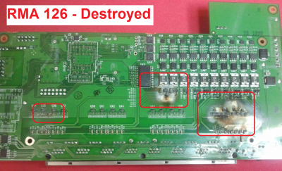

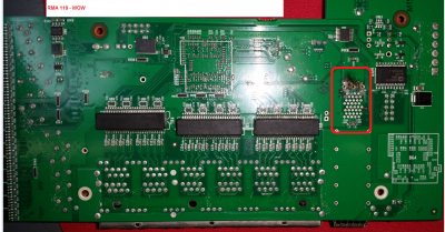

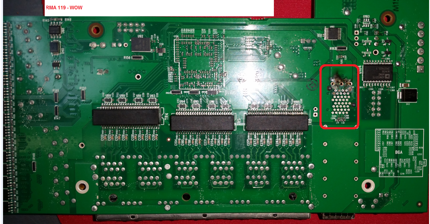

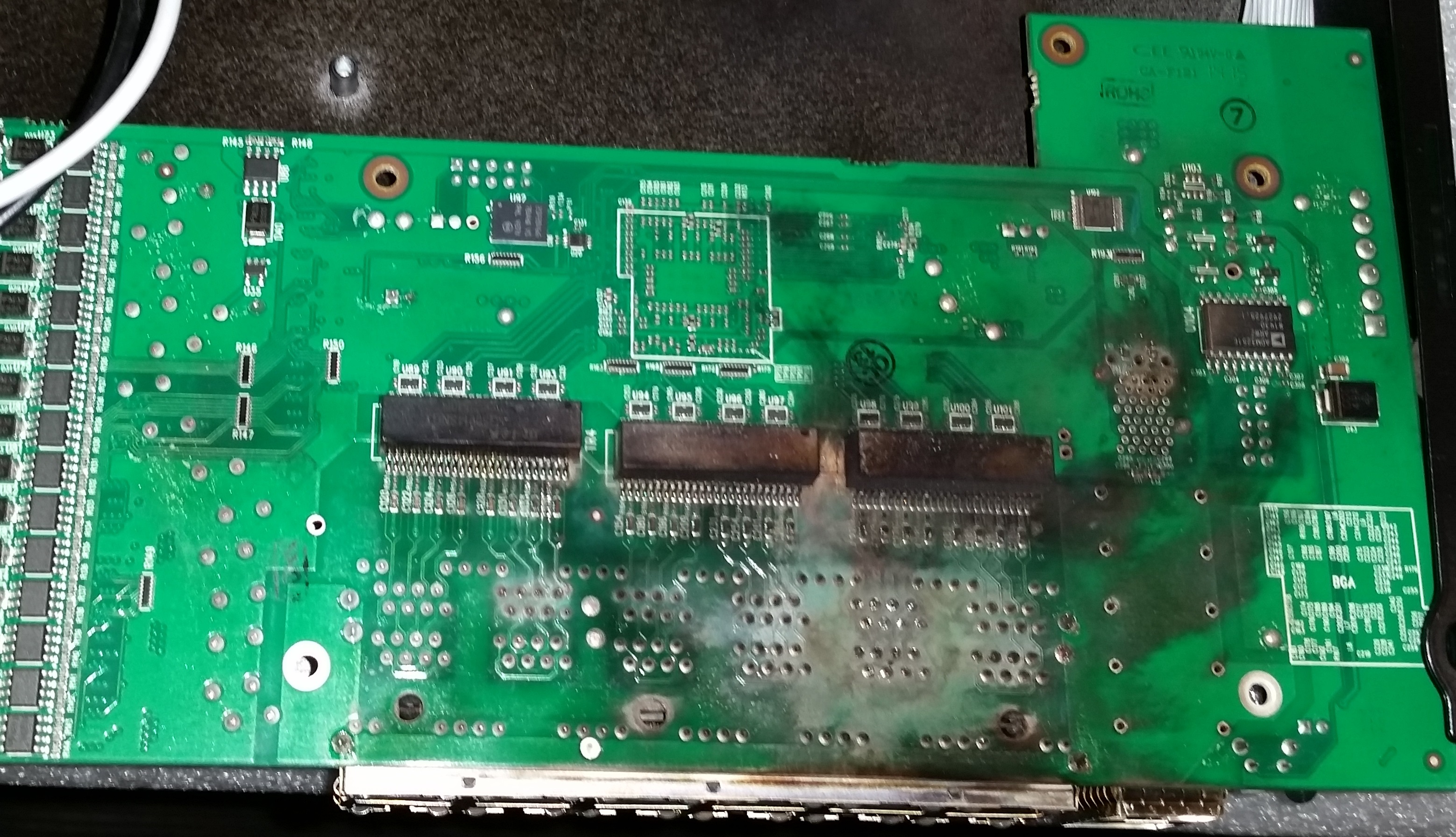

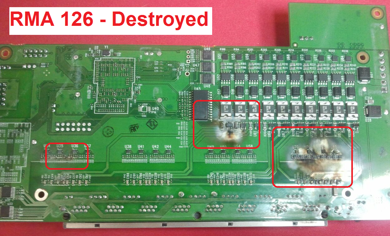

Below are some pictures of RMA units sent back for "Warranty" so you have to excuse me when I am skeptical of DOA units.
It is not impossible and if it is a valid warranty we do repair and return them FREE of charge which many people can tell you so.
But if units are damaged we charge to repair them.
Note: We charge more for the repair if they try a fast one instead of asking for the repair when they know better.
Now I am not saying this is one way or the other as I have not seen the unit I am just stumped how it could be DOA, but as I said it is not impossible just very very rare.
