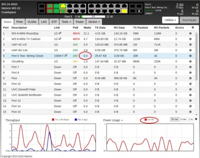

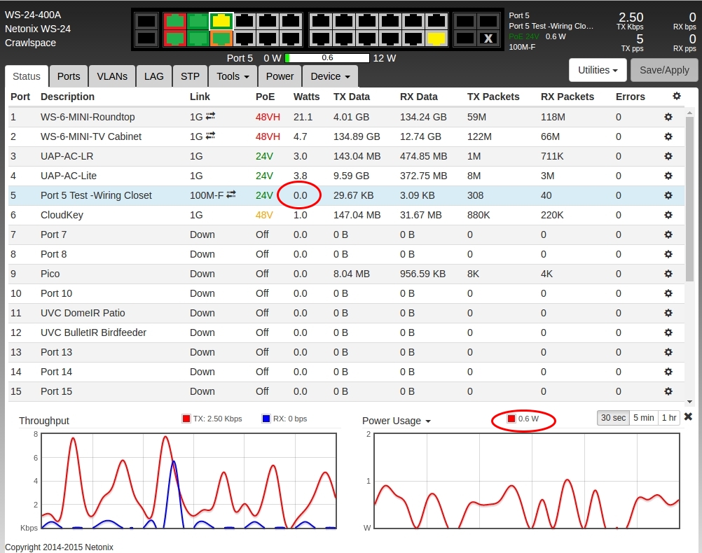

OK, I just plugged in one of my AGWs and it draws too little power to measure.
Re: log entries
I will see if we can add a checkbox to exclude ports from that error event
