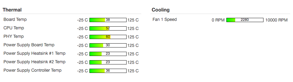

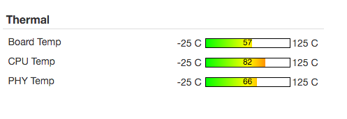

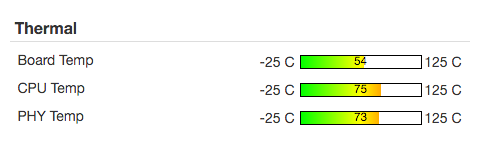

So it's been pretty warm today, how do these temperatures look? What's the "danger zone" on these units?
Also included a DC WS-8 that's mounted at ground level in a large enclosure with a battery string and such for comparison. That one's upstate though.
OIDs for monitoring the temperatures?
Re: WS-6-Mini - power supply?
They look fine!
