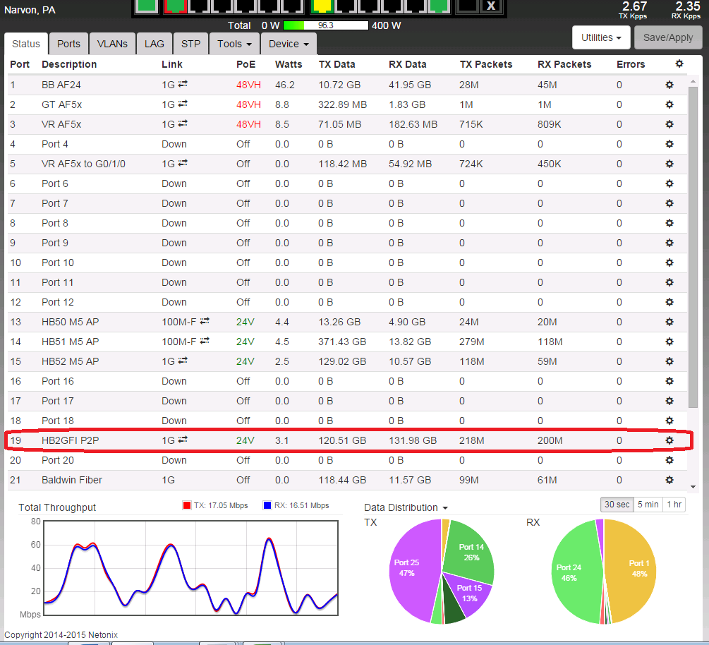

Our switches properly show when flow control is enabled on the other device and ACTIVE on our switch.

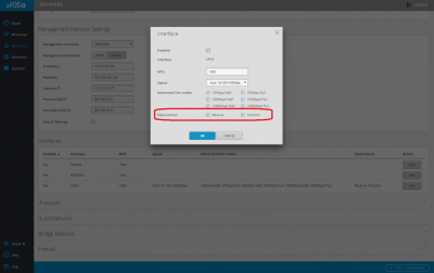

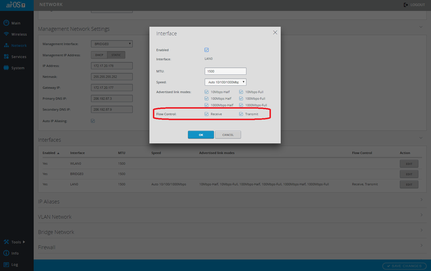

How to enable Flow Control on UBNT AC radios:
Click Network on left side.
Select Advanced COnfiguration Mode
Open Interfaces
Select LAN0 and Edit it
Enable Transmit and Receive Flow Control
Save and Apply
Then our switch show Flow Control is Active
