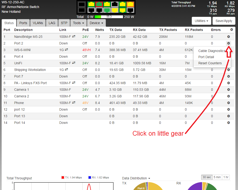

In the Cisco world, I have gotten used to troubleshooting cable issues by clearing all the counters on the port and then watching for any errors to increment. Yesterday a ws-8-250 started showing errors on one port. Today someone went out to re-crimp the cable which seems to have resolved things.
Question - I'm not seeing a way to clear the counters on a port (or all ports). Am I blind or does this not exist? Firmware 1.3.8.
Clear counters?
Re: Clear counters?
You are blind for sure.
Click on gear at top of list to clear all port counters.
Click on gear end of each port row to clear single port counters (needs v1.3.9 for this feature).
Also you need to upgrade to version 1.3.9

Re: Clear counters?
I was close, I was looking at the gear on the end of the row. Totally didn't see the gear at the top though... :)

Re: Clear counters?
sporkman wrote:I was close, I was looking at the gear on the end of the row. Totally didn't see the gear at the top though... :)
