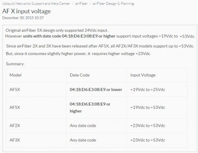

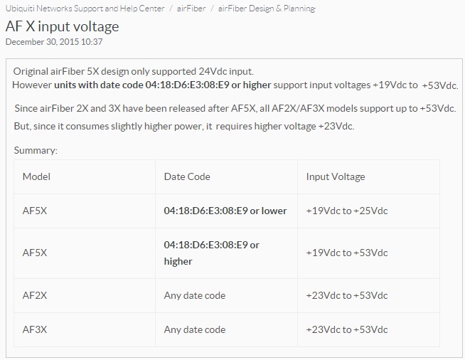

I have one site where I have a AF5X and AF3X on 48VH. Drawing between 5-13 watts watching it the last few minutes. I found that URL that says which ones dont support 48v power and it appears we got one of the original AF5X's that do NOT support it. All of our others do, I just havent tried them on 48VH yet.
Re: Confirm AFX Radios POE
Here's the URL on UBNT's wiki that details which MACs do/dont support the 48V power on 5X. Note that 2X and 3X all support it.
https://help.ubnt.com/hc/en-us/articles ... ut-voltage
