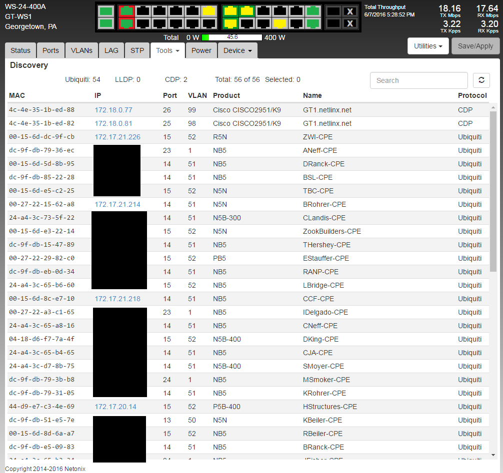

what do you need ubnt discovery for with the switch? Is it somehow talking to a crmpoint or something?
Re: UBNT discovery is working! GREAT!
Tue Jun 07, 2016 5:32 pm
givemesam wrote:what do you need ubnt discovery for with the switch? Is it somehow talking to a crmpoint or something?
You can tell the switch to respond to these discovery protocols:
UDP = Ubiquiti Discovery Protocol which would allow you to discover the switch in airCONTROL or with the UBNT discovery tool incase you mess up and forgot the IP or fat fingered it and it is now at a differnt IP.
CDP = It responds to CIsco DIscovery Protocol so other devices can find it
LLDP = Link Layer Discovery Protocol.
And if you have v1.4.2rc6 installed and enable the Discovery Tab you can log into your tower switch and discover all UDP, CDP, LLDP devices on that layer 2 segment and know stuff about them and launch their web UI with a click, see picture below:
CLICK IMAGE TO VIEW FULL SIZE
