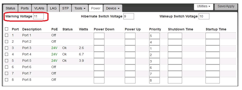

What is the possibility of getting the ability to send an email or sms message in a future software version if a user defined low voltage occurs on the raw input DC side on a WS-12-250-DC?
Re: DC power alarms
montana wrote:What is the possibility of getting the ability to send an email or sms message in a future software version if a user defined low voltage occurs on the raw input DC side on a WS-12-250-DC?
How about I tell you that it is already there!
Make sure you have SMTP properly setup and tested on the Device/Configuration Tab and you will get a lot of SMTP alerts for any error condition.
Look on the Power Tab

Re: DC power alarms
No, people have it working with other mail servers like GMAIL and such.
The settings on our SMTP setup are pretty much the same as any mail client so not sure why you would need special instructions as I am sure you have setup many mail client software such as Outlook?

Re: DC power alarms
montana wrote:Well that is great.:) Should have read the manual better.
Most of our equipment that sends the text message and goes to and address like 406######@vtext.com. No passwords required or some of the other stuff shown.
Not sure how to set that up to work with Verizon.
Not sure I understand the question since you use it with other equipment. So long as you have SMTP setup, then the Verizon email to text gateway will do it.
http://www.verizonwireless.com/support/ ... site-faqs/
For me using Rogers email to text gateway is a PITA and not free.
To cut down on the volume of texts and subsequently the cost, I used to send all of my alerts to email and then had written email rules to forward only certain content to the phone as text.
